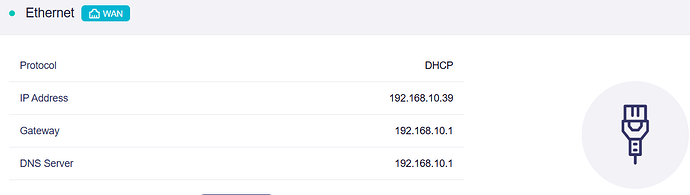

I understand your internet is there over this "powerline" device. (Ethernet over powerline)
Ok to make a Wifi AP the GL-SFT1200 can deliver this.
Connect one of the Netgear ethernet ports to the WAN port of the SFT1200
Login in the SFT1200 through wifi or via one of the LAN ethernet ports of the SFT1200
The WAN ethernet connection should start automatic, if the other end of the Netgear Powerline is connected to a router and is reachable.
Your home IP range should be seen
Something similar to this ...
(addresses here are mine, yours will be different)
In network mode you can stay on "router" mode (with its own 192.168.8.x addresses) and connect to home devices or internet from there, or switch to "access point" mode , where the wifi devices there will also get an IP address from your home network. But then it may require some searching to be able to connect to this setup page again as the IP address range is different.
