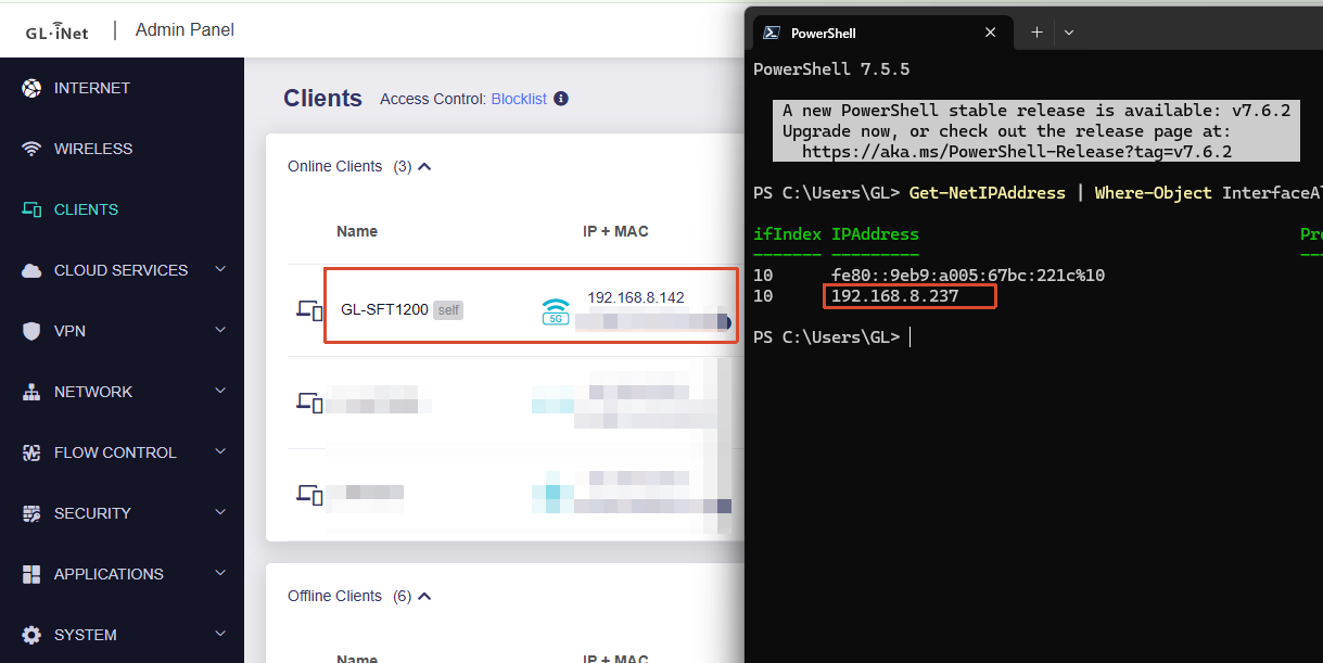

We tested locally using the SFT1200 with firmware v4.8.3 beta6.
In Extender mode, wired LAN clients were able to correctly obtain the same IP address range/subnet mask as the upstream network and remain within the same subnet:
Could you please try upgrading to this version and see whether it resolves the issue for you?

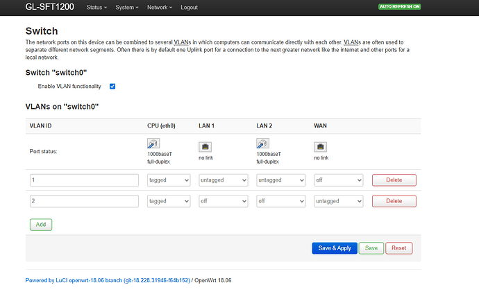

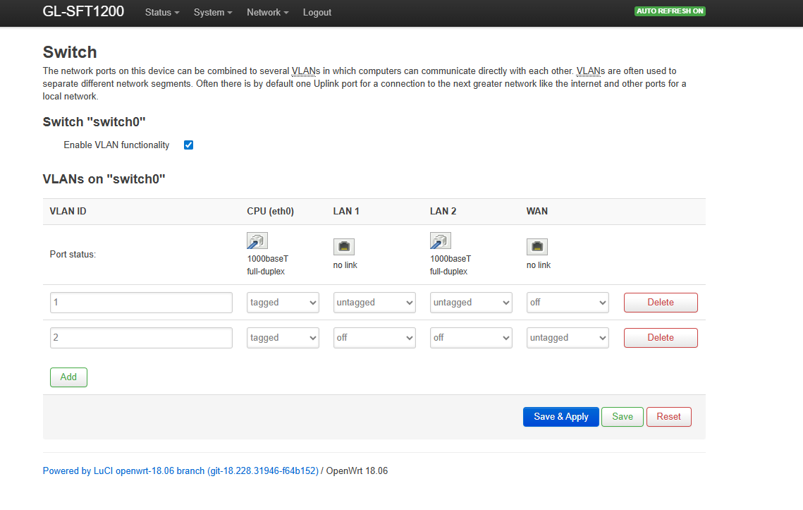

The swconfig configuration should be fine. You can visually verify it under LuCI → Network → Switch:
Our previous testing also indicates that it is functioning correctly.
