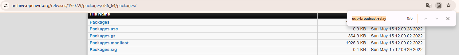

The earliest incarnation of udp-broadcast-relay-redux is in Openwrt 19.07 and Immortalwrt 19.07.
It seems a bit odd that this package can't be found on archive.openwrt.org.
But regardless, it doesn't appear to be supported on the SFT1200 running 18.06. :melting_face:
