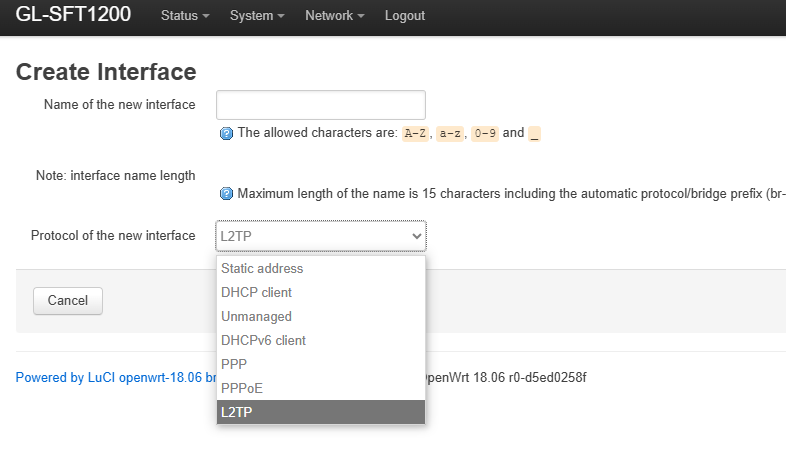

Even if you filled out necessary information here:
You don't have ability switched between protocols here:

GL GUI does not support the l2tp protocol.
Only support it by the third-party plugins and try configuring in the Luci. If you require the l2tp configuration, please move to Luci, and not touch the GL GUI.

This one syslog seems to be a problem with the interface name.
The system cannot pull up the interface 'l2tp-wan'. Probably try the original WAN port back to default.
Like:
  1. Reset the firmware.
  2. Install the l2tp protocol.
  3. Luci > Network > Interface > Add new interface, select the 'l2tp' protocol, enter your server info.
Hi. Unfortunately, it is not helped. I hope later with new firmware version Opal become useful.
