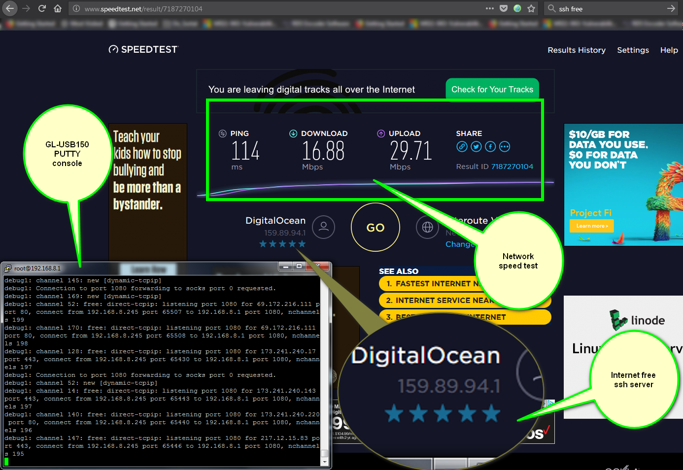

Here is the results with ssh proxy using the above command. The set back is that I have to make a putty connection to run the connection command, if you are using a phone is a little bit harder, that’s why I need integration in the firmware of the sshproxy.
