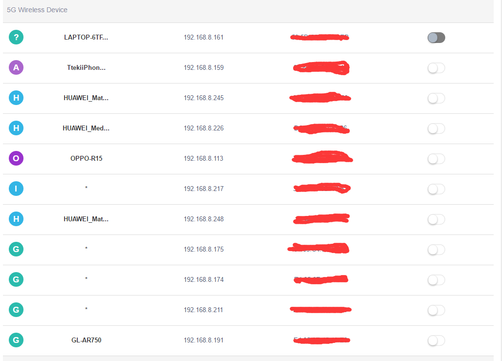

Hi, I updated the wifi driver and configuration. The firmware has been sent to you by email. I look forward to your feedback.
I have now connected 11 terminals and four are playing videos. At present everything is normal, as shown below
