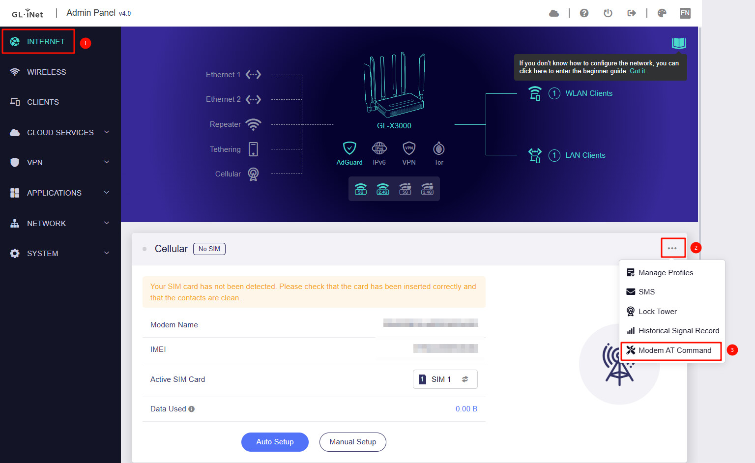

Unfortunately, the X2000 only supports 3G (WCDMA) and 4G.
But if it also helps when switching between 3G and 4G, please try to run these AT commands to lock mobile technology.
  • Switch to 4G/LTE only
AT+QNWPREFCFG="mode_pref",LTE
  • Switch to 3G/WCDMA only
AT+QNWPREFCFG="mode_pref",WCDMA
  • Restore automatic mode (3G/4G auto-selection)
AT+QNWPREFCFG="mode_pref",AUTO
After running them, please execute the following AT commands to apply the changes.
AT+CFUN=0
# Wait about 10 seconds
AT+CFUN=1
You can run these AT commands in the following interface.
