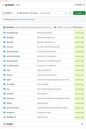

All the packages from their feed are outdated.
see GitHub - gl-inet/gl-feeds at 19.07.7

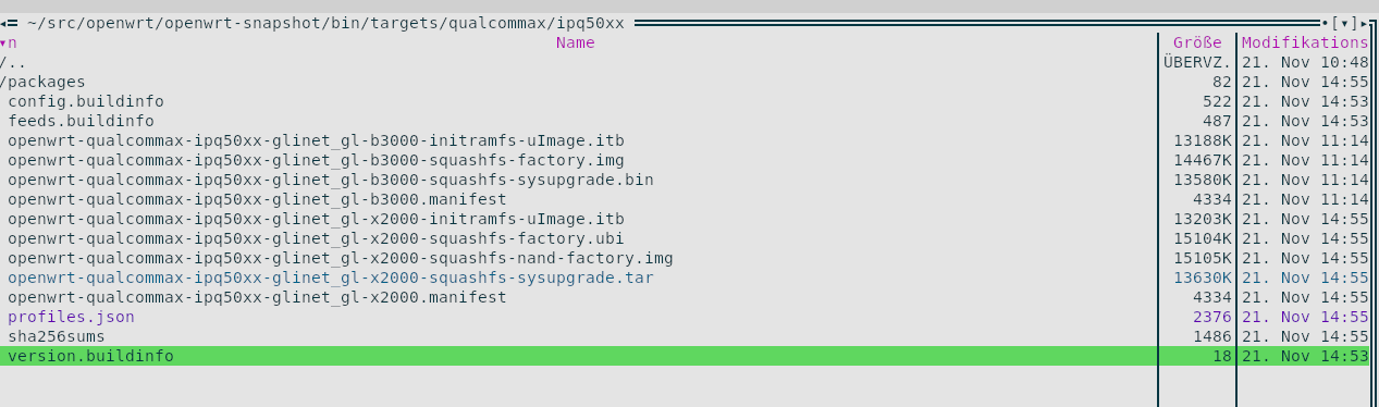

I’ve made a fork of openwrt-snapshot and integrated the patches from TheRootED24 to it. See Plain OpenWRT on GL-X2000 - Hardware Questions and Recommendations - OpenWrt Forum for the discussion.
I have a build for the GL-X2000 which will obviously lack LTE-functions. I will try it out, when i have the time.
