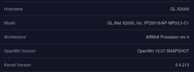

GL-X2000 with openwrt 19.07 - what the

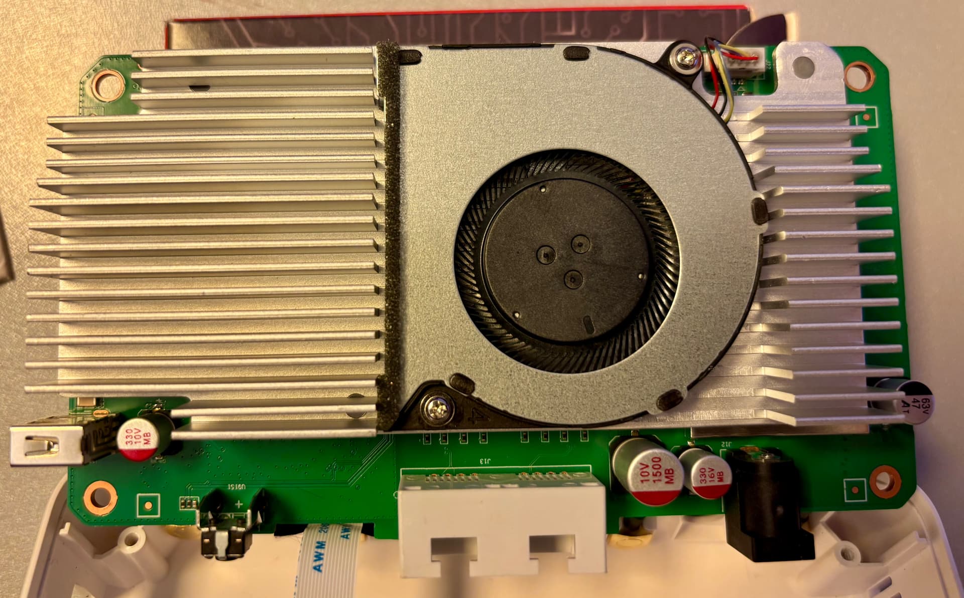

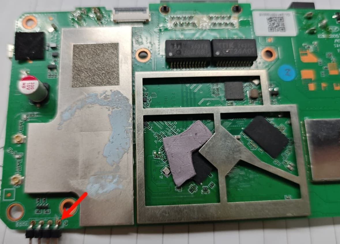

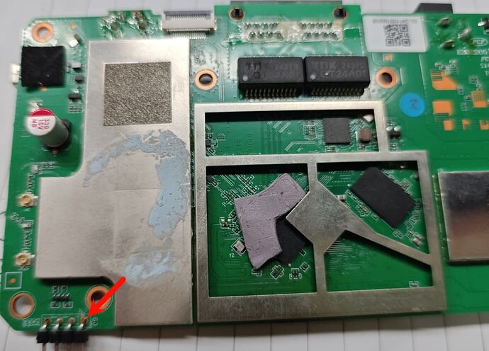

Could someone from the GL.iNet Staff ( @bruce :eyes: ) point out, where the UART/TTL-Pins are located?
I want to try out an initramfs-Image without flashing the device.
Thanks

why is the X2000 pin out missing on it’s datasheet?
If you check the X750 datasheet, last page gives the pinout, same with XE300 and the Collie
It's being covered by the heat sink, here you go
The new product no longer includes a PCB layout figure.
First boot with openwrt-snapshot
BusyBox v1.37.0 (2025-11-21 01:17:53 UTC) built-in shell (ash)
  _______                     ________        __
 |       |.-----.-----.-----.|  |  |  |.----.|  |_
 |   -   ||  _  |  -__|     ||  |  |  ||   _||   _|
 |_______||   __|_____|__|__||________||__|  |____|
          |__| W I R E L E S S   F R E E D O M
 OpenWrt SNAPSHOT, r31963-881546450f

root@OpenWrt:~# uname -a
Linux OpenWrt 6.12.58 #0 SMP Fri Nov 21 13:41:42 2025 aarch64 GNU/Linux
root@OpenWrt:~#
