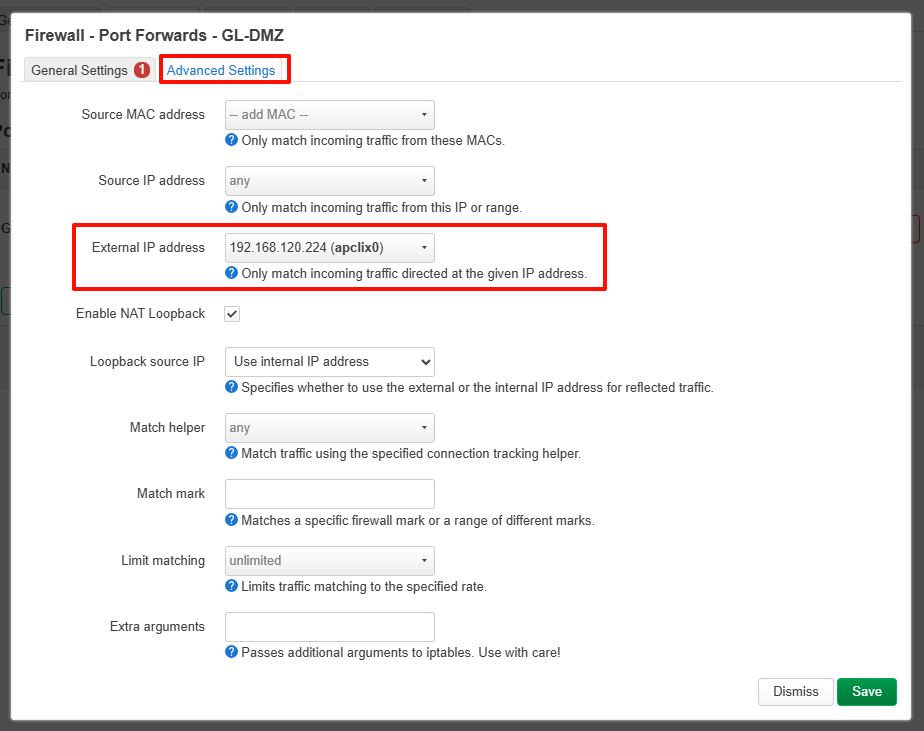

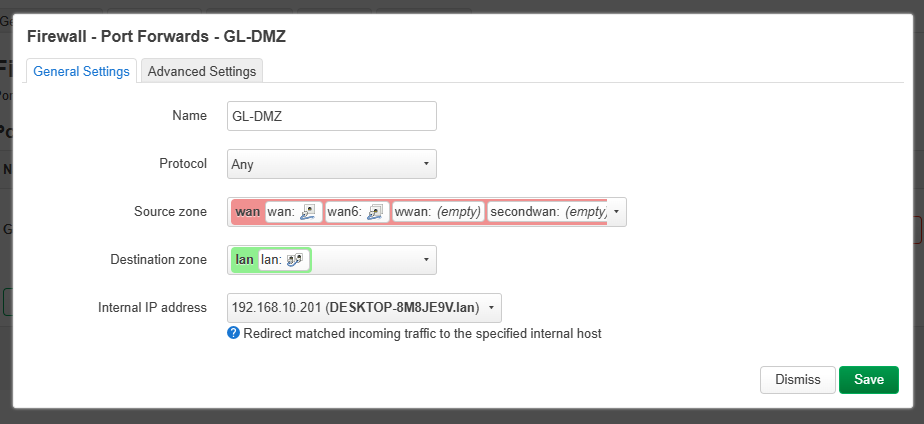

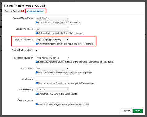

If you have a second WAN and plan to configure two DMZ rules, we can achieve this by creating multiple DMZ rules in Luci - Network - Firewall - Port Forwards.
Here's one example:
Enter the Internal IP address based on actual setup, keeping all other settings the same as shown in the screenshot.
Go to Advanced Settings tabs, Select the External IP address of corresponding WAN port (WAN1/WAN2) based on actual setup.
