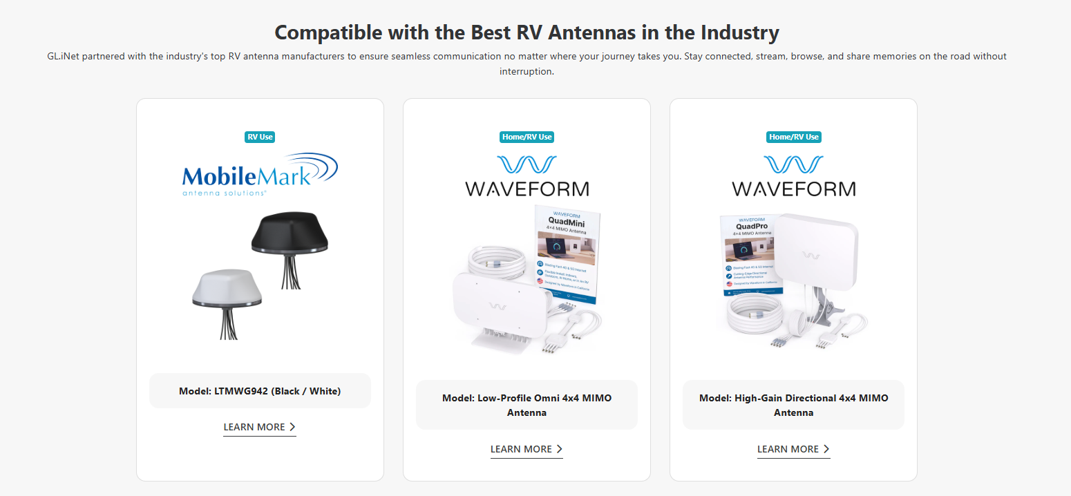

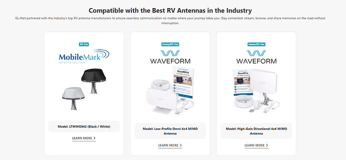

Additionally, we’ve recommended some antennas at the bottom of the product page—you may find them helpful:

I have the similar GL-XE3000 Puli (The one with the battery) I got the Wavform Quad Mini and is really good I’m about 1.5 Miles from the cell tower and get good signal.

No, if you get that Waveform kit, you leave the router inside and use the existing Wi-Fi antennas inside too, and those can also be upgraded (we’ve not needed to)

Thanks for all the comments, I ordered the Waveform OmniRoam: 6-in-1 Low-Profile Mobile Antenna (4G/5G & WiFi). I will find out if the new antenna will be powerful enough for the devices inside my food truck.
