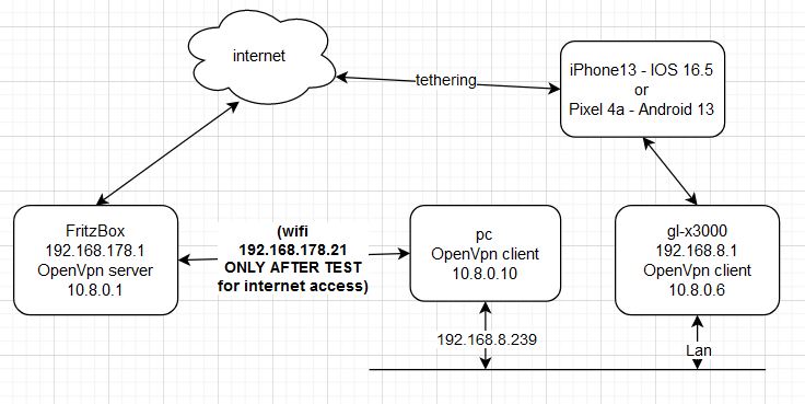

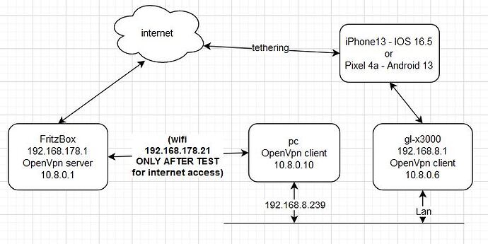

You drawing your graph. So my understand you hotspot from your phone via 4G/5G?
Overall you have 2 wan (two cloud Internet)

Yes, 2 wan, but the FritzBox wan is isolated from the GL-X3000 wan.
The OpenVpn server is on the FritxBox wan.
I also use the FritzBox wifi for internet access.

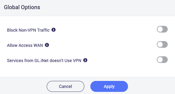

The whole OVPN thingy confuses me. You didn’t enable Block all Non-VPN traffic by chance, do you?
