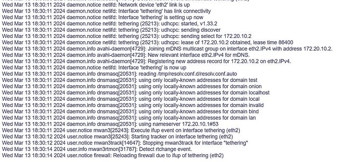

GL-X3000 iPhone tethering up but no Internet connection
tethering goes up, but without Internet :cry:

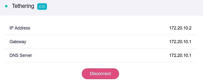

ok, I did set up this test bed:
  • my pc connected with eth to gl-x3000
  • only tethering interface up and running
this happens:
  • can ping google.com and amazon.it from ssh
  • can ping 9.9.9.9 from ssh
  • cannot ping/navigate from my pc ??? BUT ADDRESS IS RESOLVED !!!
    (I tryed to ping my public nas and address is the same both on ssh and my pc)
this drive me crazy :flushed:

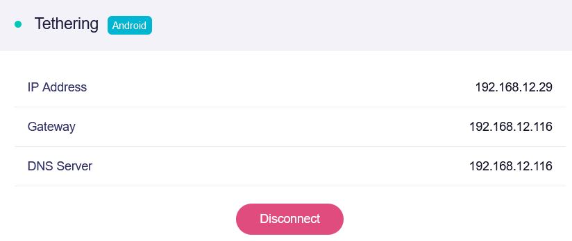

same problem with an Android pixel 4a:
ping name resolved, but no answer.

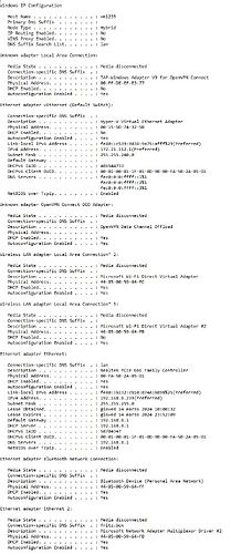

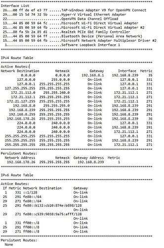

What’s the output of those commands on your PC?

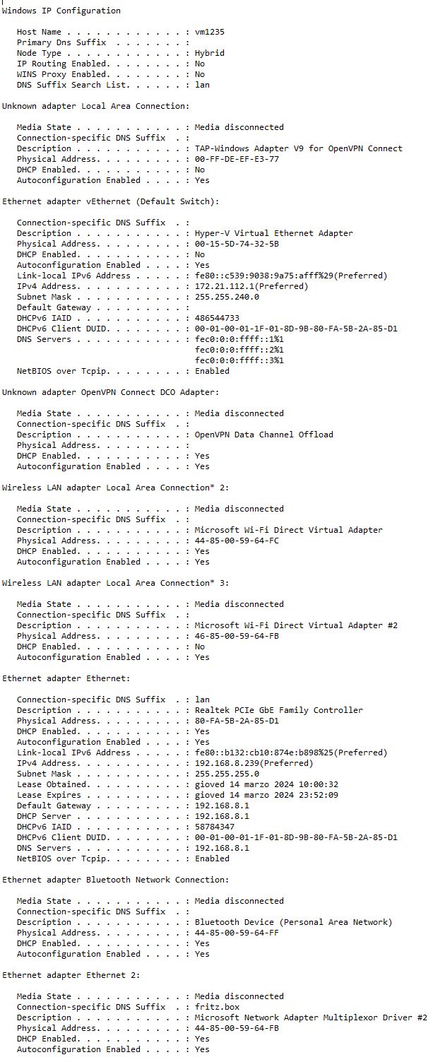

ipconfig /all
route print
note: my ip is IPv4 Address. . . . . . . . . . . : 192.168.8.239
(is there a way to send text files?)
Looks good so far.
This one confused me, but it should not hurt anyone.

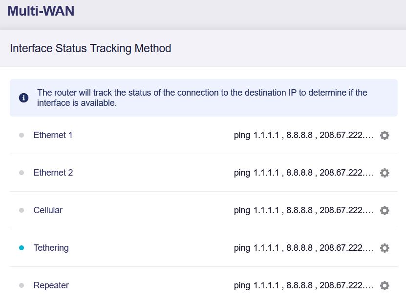

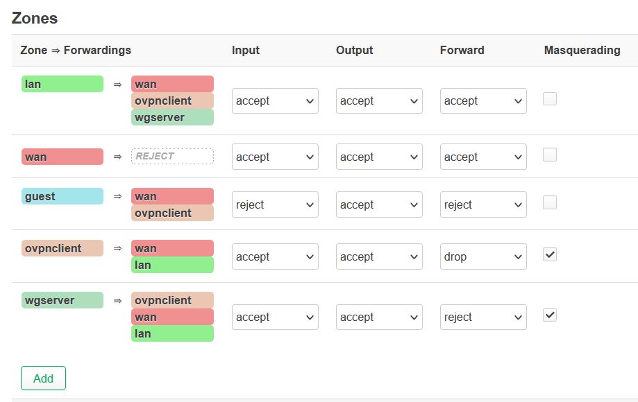

these are my current (default) Zones:

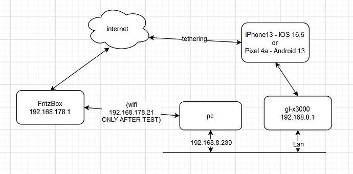

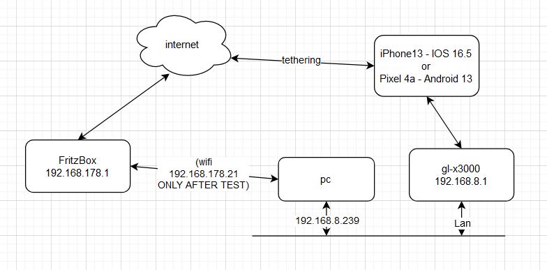

Something appears to be odd to me. Can you quickly draw a sketch of your network?
draw.io will help. Please include IP addresses.
very nice tool, never stop learning :hugs:
