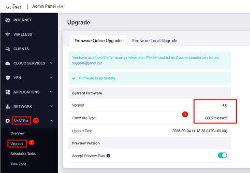

Could you provide a screenshot from Admin Panel - System - Upgrade?
If it matches what I provided (4.0 & 0802release5), then this version is indeed stable.
However, we discovered some defects after release and have since removed it from the download center.
The current snapshot version in the download center is 4.8.3 snapshot, not 4.8.2.
It might be a misunderstanding.

  • Could you provide a screenshot from Admin Panel - System - Upgrade? See below:
  • If it matches what I provided (4.0 & 0802release5), then this version is indeed stable.
    However, we discovered some defects after release and have since removed it from the download center. So this version (4.0 & 0802release5) was flagged as “stable” and listed on the “stable” download page (https://dl.gl-inet.com/router/x3000/stable) sometime before Sept. 23rd, and then was pulled sometime afterwards? That would explain why my unit prompted for upgrade even though “Accept Preview Plan” was (and always has been) disabled
