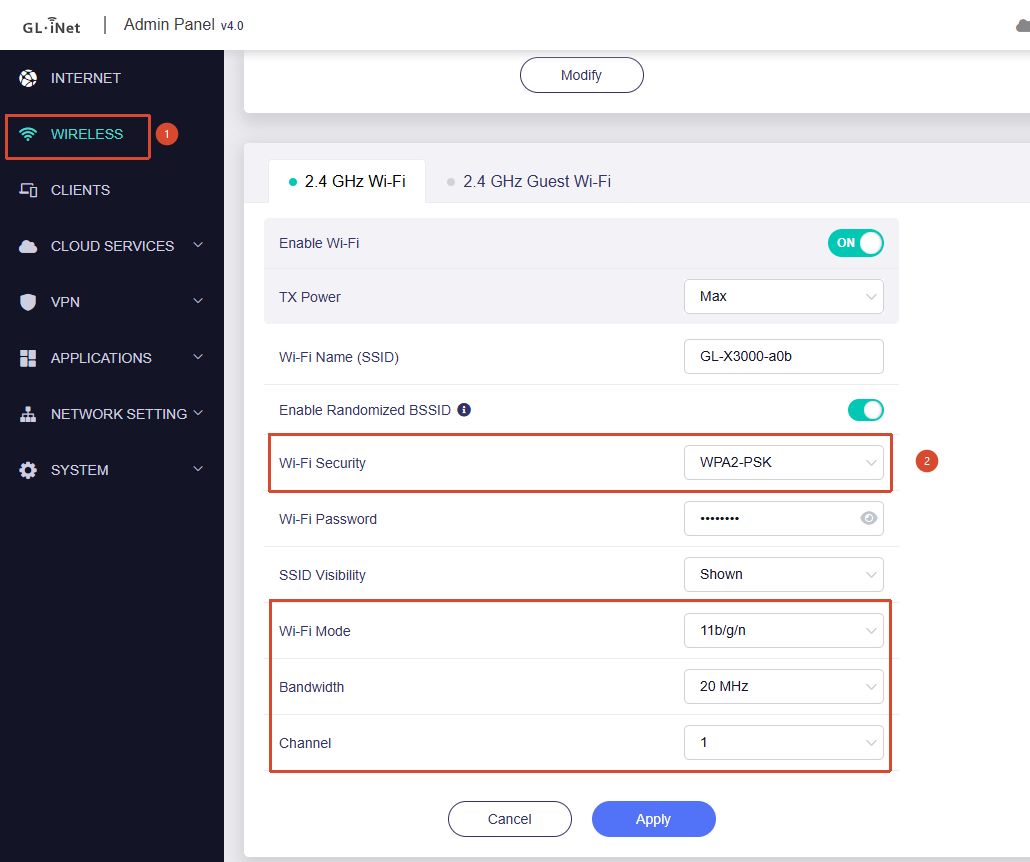

  3. Try adjusting the 2.4GHz settings to 11b/g/n + WPA2 only, or WPA/WPA2 + fixed 20 MHz channel width + fixed channels 1/6/11 to see if it helps:

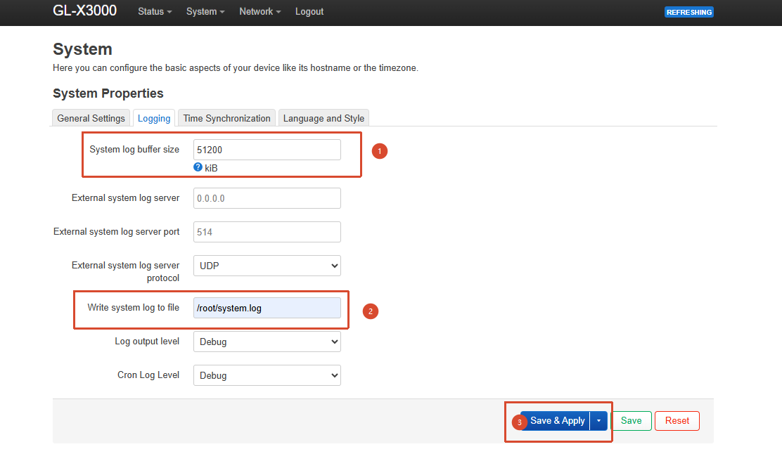

  4. If the issue still occurs, go to LuCI → System → System → Logging and enable saving logs to flash storage. After the issue happens again, export the device logs and send them to us via private message for further analysis:
