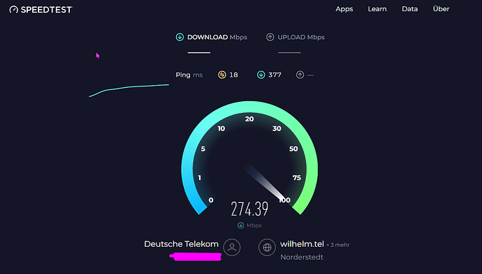

I got now something about 240 Mbit/s with the router and 380-420 with my Mobile phone (Xiaomi mi 11 Pro). Only thing that would be interesting to know is why my Phone still has better connection even it has no extra antenna and is very compact.

I start setup my 2nd X3000 and just did the latest update (4.4.8) and it imidiatly start connecting with 5G NSA (which my old one with old firmware had problems with).
But the Connection is only 90 Mbit/s even it has same Simcard as my other Device with 250 mbit/s.
I also change the Profile to “ROW_Commercial”
The only difference is the modemfirmware.
