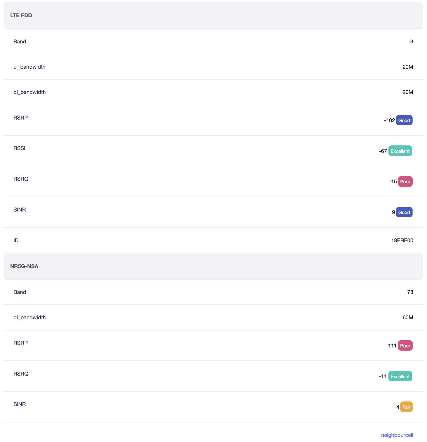

When this bug appears I can't check the connection levels because the dashboard doesn't let me access it.
I can't believe it would be a unstable connection because it shows that I have 3/4 bars of connection strength and almost 0.5Gbps download speeds with 5G NSA.
