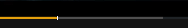

But Plex won’t stream. The client loads the initial buffer, plays a few seconds, and then stops. No continuous loading.
Here’s how it normally looks when it works:
