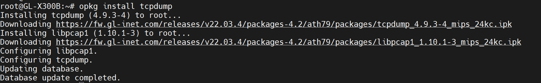

Hi GL.iNet team, opkg update is failing on my GL-X300B. The specific feed that seems to be causing the issue is:
https://fw.gl-inet.com/releases/v22.03.4/packages-4.2/ath79/packages
When I download and inspect its Packages.gz, it shows packages with Architecture: aarch64_cortex-a53, which looks different from the expected architecture for the GL-X300B/ath79 target. If I comment out this feed, opkg update works again, but some packages are no longer available. Could you please check whether this feed is pointing to the wrong package index or wrong architecture?
Thank you for your feedback.
We’ve asked our R&D team to investigate and fix the issue.
The issue should now be fixed.
Please run opkg update and then check whether the plugin can be installed properly.
