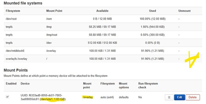

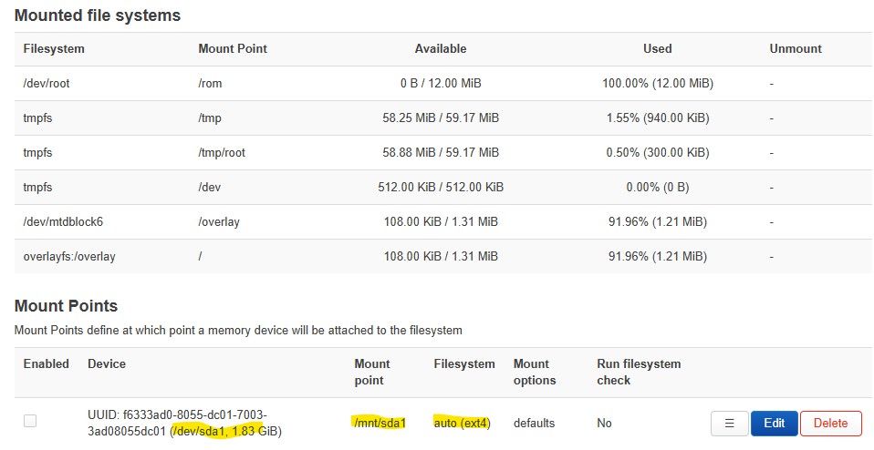

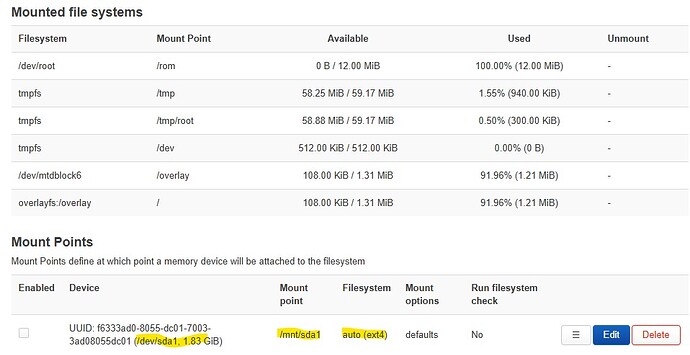

The SD card was formatted as ext4 under Windows 11 using "MiniTool Partition Wizard" and installed in the internal SD slot.
I can find it under Mount Points, but it's not mounted.

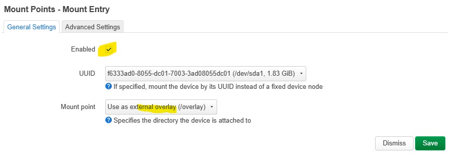

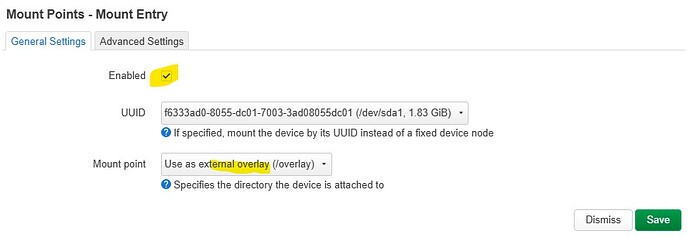

Next, I configure /overlay under Edit and check the "enabled" box.

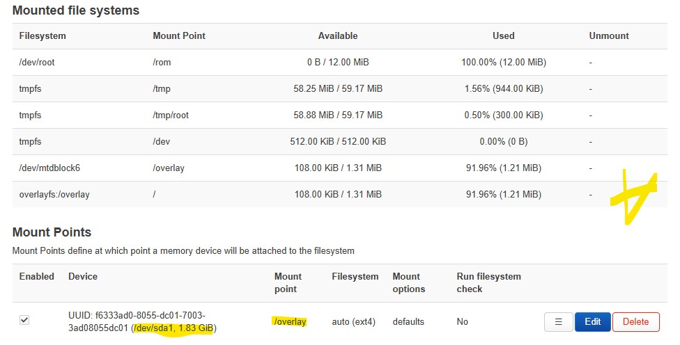

Everything is then displayed correctly under Mount Points. After "Save & Apply," however, this mount point doesn't appear in the Mounted file systems.
Even when I click on "Mount attach devices," nothing changes.
What am I doing wrong?
