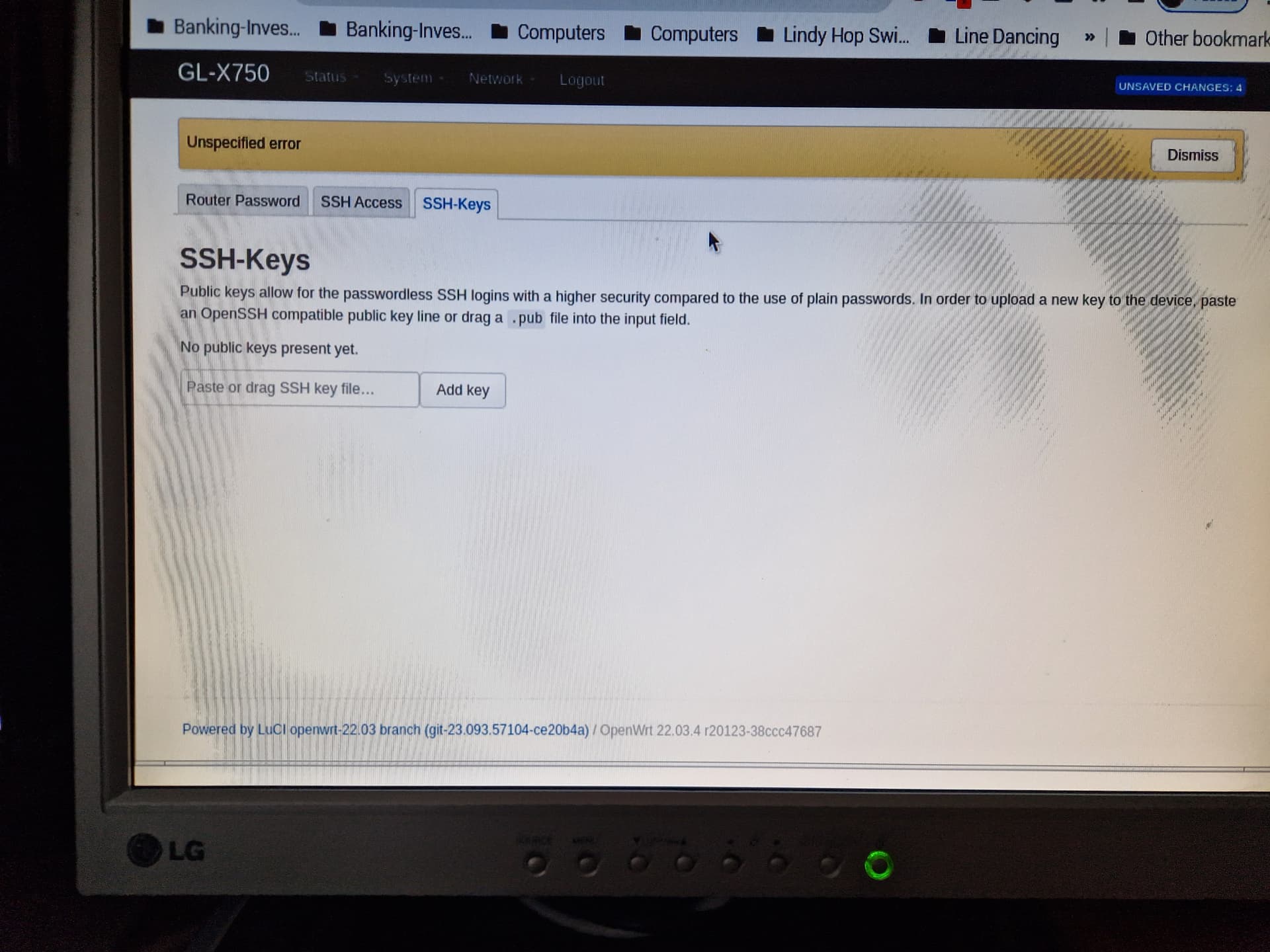

I have upgraded to the latest firmware and I am having problems with accessing the router over ssh. and when making changes with Luci nothing is saved of changed.
I do not seem to be able to save any changes made in Luci at all
Ssh keys gives unspecified error all the time.
I have the unsaved changes in the top righthand corner which never goes away no mater how many times I press ‘save and apply’.

Do you have a screen of this error?
I have id_rsa.pub and id_rsa files in .ssh folder.

Also showing is the unsaved changes, which never changes?
So it does not work when you copy the content of the id_rsa.pub file into the input field?

Sadly NO. I get Permission denied (public key,password)
I cannot turn off password in Luci. I get unsaved changes
Go for some reset then, since there seems to be an error.
