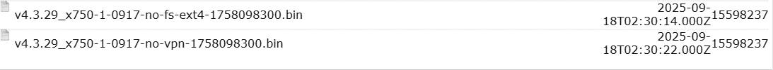

X750 v4.3.29 Safe Iterative Firmware:
http://download.gl-inet.com/firmware/x750/esim/
Amazing Thank you and the team for working on this!
