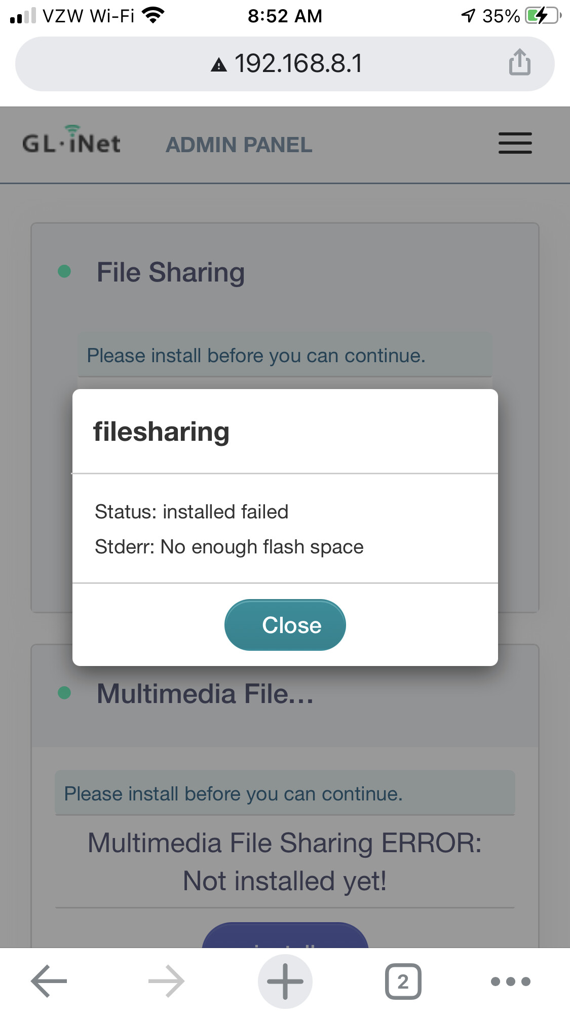

I HAD to get this modem in order to use Traveldate services. I have had nothing but issues getting file and media share installed and running because of memory issues. I installed a 2gb SIM thinking this would be an easy fix but NOOOO, you need to know how to write code in order to use the SIM card. I have followed all the settings and recommendation found on this forum and nothing is working. I contacted support and they sent me direction thinking that everyone knows how to do this stuff, this is very frustrating and at my wits end. What can I do to address this issue???

Yes I did and everything I try is not working. I even reformatted the SD to EXt4. point is they should install enough memory to do the basic and not make everyone jump through the hoops
