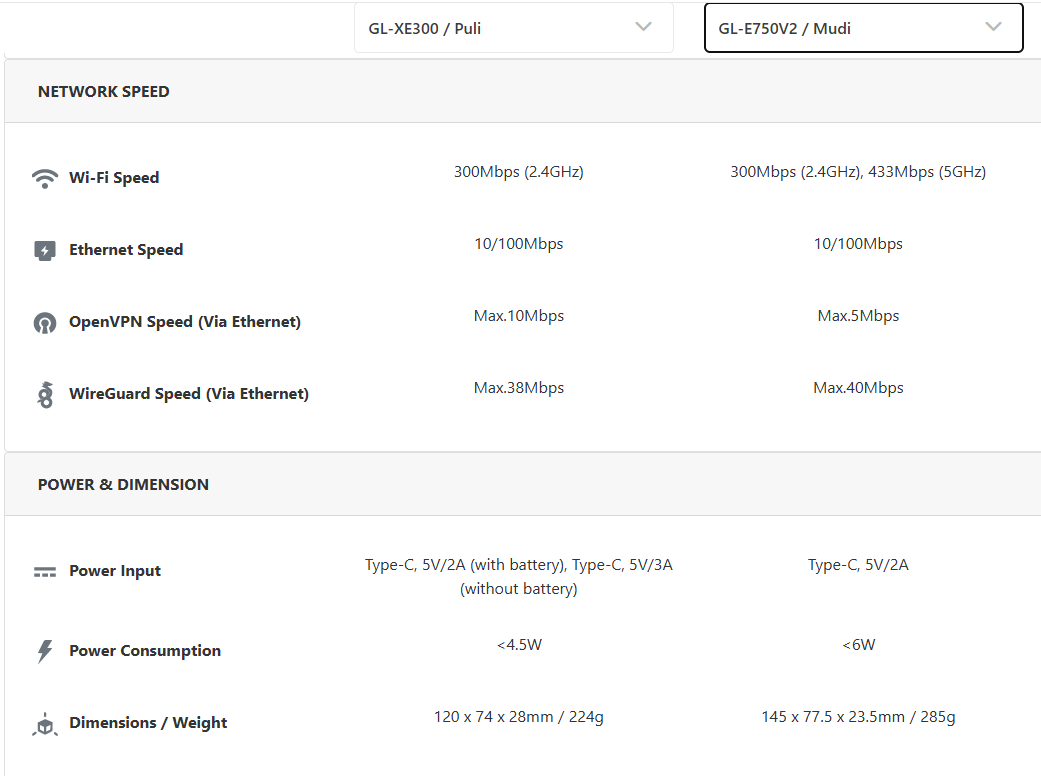

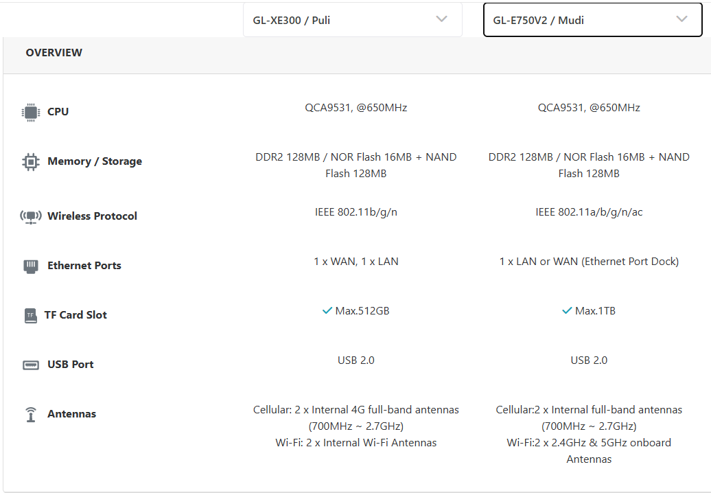

I'm very out of my depth here and hope folks can help me out. I live in USA. I need a wifi hotspot in my car that is always automatically on when the car turns on. Someone said to check out the GL-XE300 (Puli) or GL-E750V2 (Mudi).
I can't tell the difference between the two and I'm unable to confirm/find a few things. Namely:

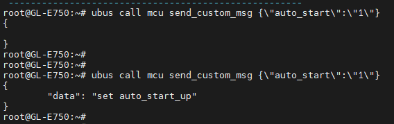

    E750 may need to configure some command settings to enable automatic power on.
    ubus call mcu send_custom_msg {\"auto_start\":\"1\"}

Great! Thank you!
