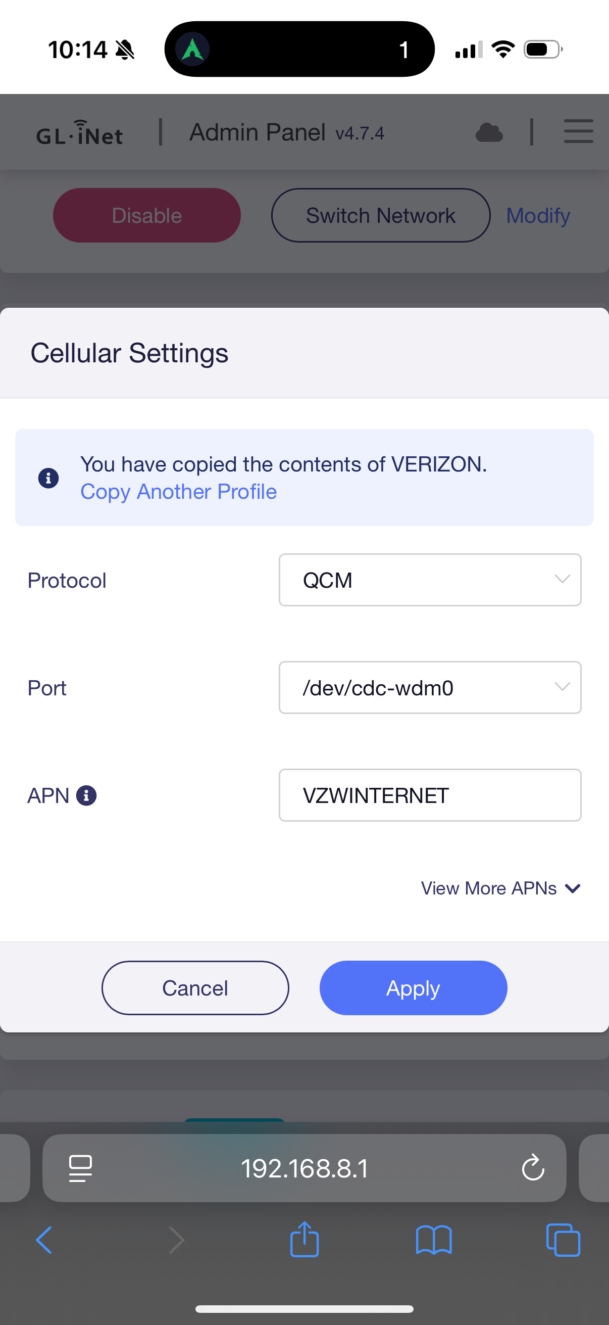

I’m trying to connect a wave share usb modem similar. I don’t think I have the port configured properly to establish the connection. At one point it had the cell number but now just stick with the SIM not registered and connecting messages.
The output of
gl_modem -B 0001:01:00.0 AT AT+QNETRC?
“Modem is not exit.Please make sure bus.”
Any thoughts how to get this to connect?
The profiles are confusing. It seems to choose a dev path but the only actual options as the usb, should this be a usb or a cdc path?
