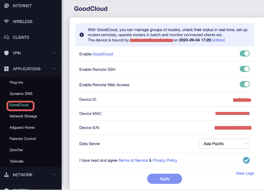

How do you requeste the technical advice? send email? or use chat? does our technical support help you to analyse?
Can you follow the attachment document to share your device to us, and then send your device mac address and password to our email([email protected]). I will do our best to help you solve your problem.
Share the device to technical support via Goodcloud.zip (206.0 KB)

I have reviewed the attached document and do not have an option select “Remote Access” under Applications so cannot proceed as requested.

I think I can help you to anaylse again, if I fail, we will help you to returen the device or change new one, please refer to the picture below to open goodcloud and plug the a Ethernet cable to provide internet, and then use the email tell me your device mac address and password.
