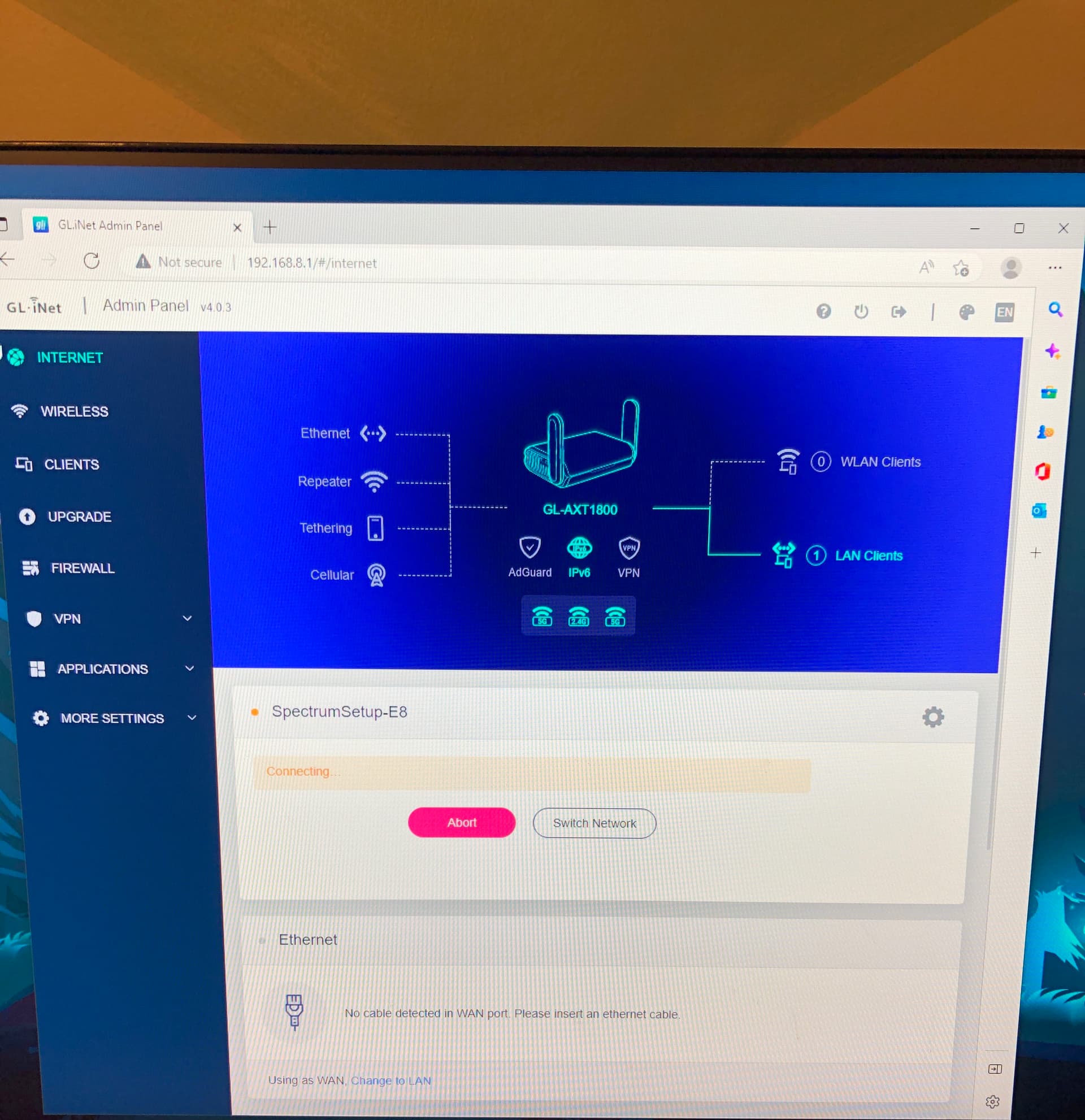

GLAXT1800 shows connecting, but not connected
Trying to connect my son’s desktop computer through ethernet port which does not have wifi capability or a wifi adapter installed and via LAN on the DL device. Continues to show “connecting” to our Spectrum internet’s wifi base (in another room), but his computer does not connect from the set up/admin page. We clicked the repeater option, but it’s not working. Not sure what I’m missing or if there’s a setting I don’t have checked.

Thanks! Are you suggesting that I select the router option for the GL device? That’s what we chose from the onset. I do have the correct password for our internet/wifi entered in under the settings. It just says “connecting”, but not connected and doesn’t connect. When I load Chrome or MS Edge, it prompts us to run a diagnostic test since there’s no internet access. To clarify, I have the GL device plugged in to one of its LAN ports to my son’s ethernet port on his non-wifi’d computer.

I see that your firmware version is 4.0.3. This version may be a little long. Can you upgrade the latest firmware to test whether it can be connected? GL.iNet download center
Thanks, I updated/downloaded the new firmware to 4.1 and it still gives the same “connecting” with no connection message. I rebooted computer, signed into the admin panel again, double-checked the wifi SSID and password, called Spectrum, my ISP, and there’s nothing blocked on my end. I also tried it on my MAC and shut off that laptop’s wifi to try the repeater and I received the same message as my son’s PC desktop. Not sure what else to try or do. I appreciate everyone’s help, but it looks like I will need to return this device. (We do get an internet connection on this device through the ethernet connection with the WAN line connected to the Spectrum wifi router, with a LAN line running to my son’s computer with the super long Cat6/ethernet cable in the other room where the wifi router is. However, that’s the same as us just running the 70 foot cable from his ethernet port to the Spectrum wifi modem without the GL device. Was trying to avoid running long cables.)
Are you trying to connect to the Spectrum wifi over IPv6, which is shown in your photo?
Can you also test if it connects when closer to the Spectrum wifi (10-15 ft)? If it still does not connect, then post the System Log that may have error messages.

Thanks, yes, I was trying to connect to the Spectrum wifi over the IPv6. When I tried on my Mac laptop, I was about 3 feet away with the GL box to the Spectrum wifi router…I’ll try in the morning - my son is sleeping now :).
Can you turn off IPv6 and try connecting over IPv4, if that is possible on the Spectrum router?

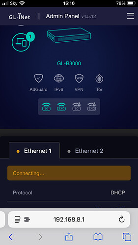

I have the same issue...
The new Marble GLB3000 wont connect my ethernet...
But i have a link established, succeed in connecting a handshake but no "internet"
Help!!
