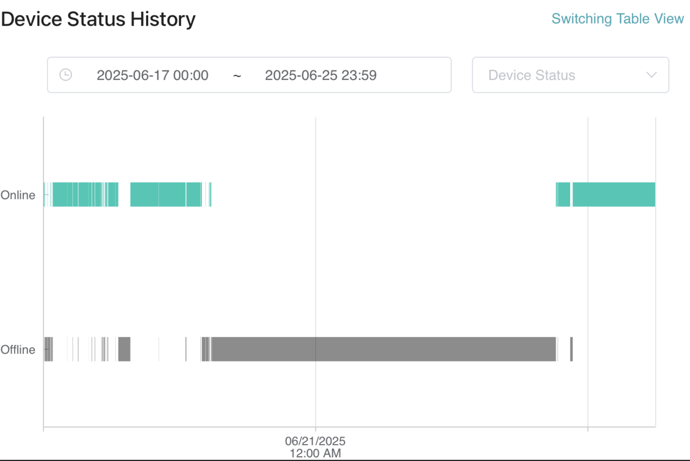

Hi Bruce,
For some reason, it's now resolving again. There was an intermittent power outage at the location in San Francisco, causing a reboot of the device, but as mentioned I was always able to connect to it using the IP (during the offline period in the timeline attached). When I tried to do an nslookup, attaching to either ns1.glddns.com or ns2, only the Australia device (lf2ad58) would resolve. It couldn't return an IP for the US device (zza7929). Are your DNS servers using DDNS so if a host is not reachable by the server, the host entry is removed? What else could have caused this issue?
Thanks,
If report (renew) the IP is timeout from router DDNS, the DDNS server will remove this record.
For example, if the US device zza7929 is not reported, the entry of zza7929.glddns.com will be remove, nslookup may could not resolve the IP.
Waiting for the router to report IP again, DDNS server will record the IP again.
