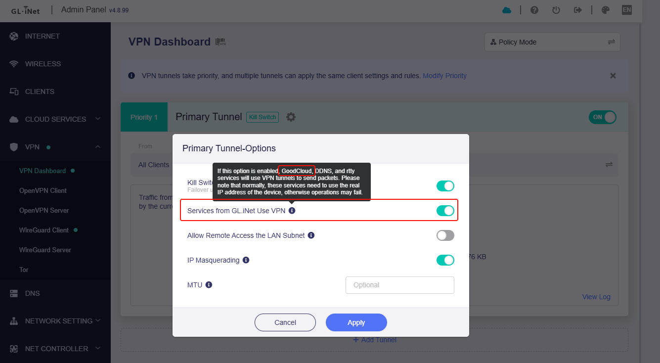

Now that the background is out of the way - Is there a way for me to just send the GLI service connections through a commercial VPN? I’ve got PIA but I really don’t want to deal with sending EVERYTHING through it. I really want to be able to update services without having to resort to connecting the router to my phone hotspot and be able to manage via GoodCloud.

You can toggle this option on:
If say you don't want all clients to go to VPN, you can switch policy mode in VPN Dashboard and Specified Devices to select an offline client at will.
In this way, will only GoodCloud uses VPN, and other clients will not use VPN.
