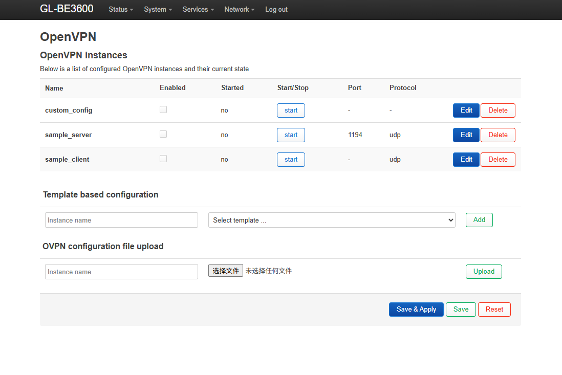

It appears there is an issue with the BE3600 LuCI interface that prevents the VPN → OpenVPN in menu from displaying correctly. We have reported this to our development team for further investigation and a possible fix in a future release.
In the meantime, you can access the OpenVPN configuration page directly using the URL below. Please note to replace the IP address and port with those used in your setup:
http://192.168.8.1:8080/cgi-bin/luci/admin/vpn/openvpn

2026-01-09 Update:
We have fixed this issue in the snapshot builds .
The stable version will merge this fix in the next release.
