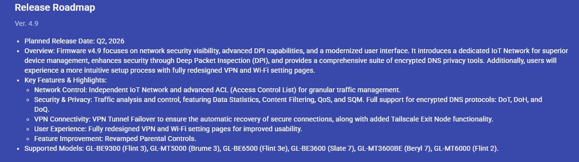

When the 4.9 it’s expected to be released?
