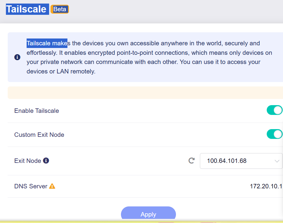

The problem I have run into is if I shut down the router and turn it back on it does not re-establish a connection to Tailscale. The first time it happened I had to kill Tailscale using the cli on the router and rerun it and bind it again etc I have turned it on and off again and again it cannot connect to tailscale. In Luci the tailscale0 network interface fails with the error message DEVICE_CLAIM_FAILED. The admin panel looks like this

I did a test locally, using MT3000 as a VPN client and Tailscale turned on at the same time. At this time, the virtual IP address obtained by MT3000 from Tailscale can be accessed normally.
Restart MT3000, wait for the router to automatically connect to VPN successfully, and then it will automatically connect to Tailscale. You can also use the virtual IP to access MT3000.
There are some attempts: You can turn off the firewall to test whether you can reconnect to Tailscale. Or maybe the VPN ISP network has restrictions.
