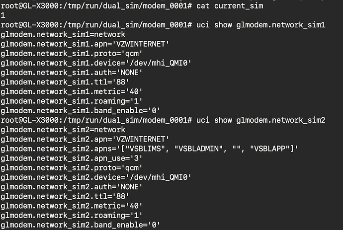

GLx 3000 spitz 5g keeps disconnecting and changing apn for no reason

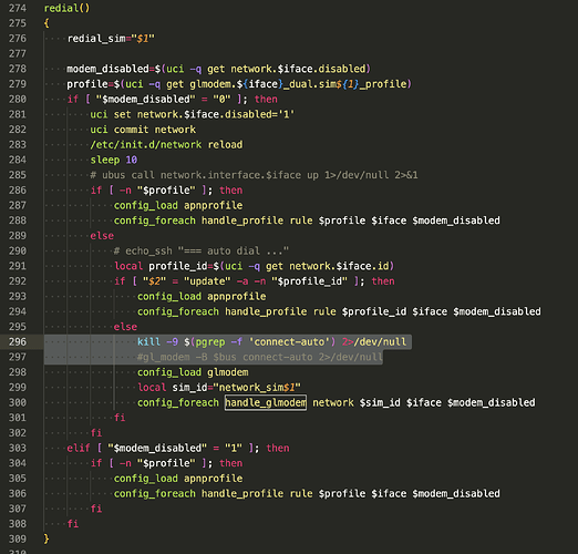

Which file do I modify for this suggestion?
Access the background of the router using ssh
Change redial_sim to sim
@ywp thanks, missed the filename at the bottom. It's currently in a bad state again where it chose internet as the APN, can I test this by running it somehow?
After modifying it, modify the apn to be correct
See if the problem reappears
Can I add some logging so we know it is no longer using the wrong redial_sim variable instead of just blindly trying?
Which scenarios does switch_sim_slot run?

I did a bunch more digging around to understand what is going on that would cause internet to populate in the APN. Here's the output from the command that should be selecting the correct profiles.
However...
I'd challenge you to consider, what if those uci values (network.modem_0001, glmodem.network_sim1 or glmodem.network_sim2) are unavailable?
The way that the router recovers currently is not great, it seems the behavior is for it to try to renegotiate a profile with the modem and never recovers because it overwrote the existing profile with the WRONG auto negotiated profile back to Luci.
This is exactly what is going on here:
In other words,
By running gl_modem -B 0001:01:00.0 connect-auto as a fallback we're now allowing the modem to change the profile values on it's own in Luci it seems is the current behavior.
You know when you see a kill -9 and some commented out code there's bound to be a bug :rofl:

Technical Support via GoodCloud.tar (192 KB)
When something goes wrong, can you go to the overview page to see your router's uptime?
Make sure the router was restarted before the problem occurred.
Please disable the automatic sim card switching function
If possible, please connect the cable and share the device to goodcloud and don't restarting when the problem occurs

@Kwhite @Xellos @dOGHAIR
ssh 192.168.8.1
vi /usr/bin/switch_sim_slot
add " "
try test
Please be more specific regarding the " " is it not possible to literally spell it out?
I'll look again and see if I can make sense of it but it doesn't jump out at me on first glance. Where do I add the " "?
Thanks
You need to add it yourself
You can compare it here
