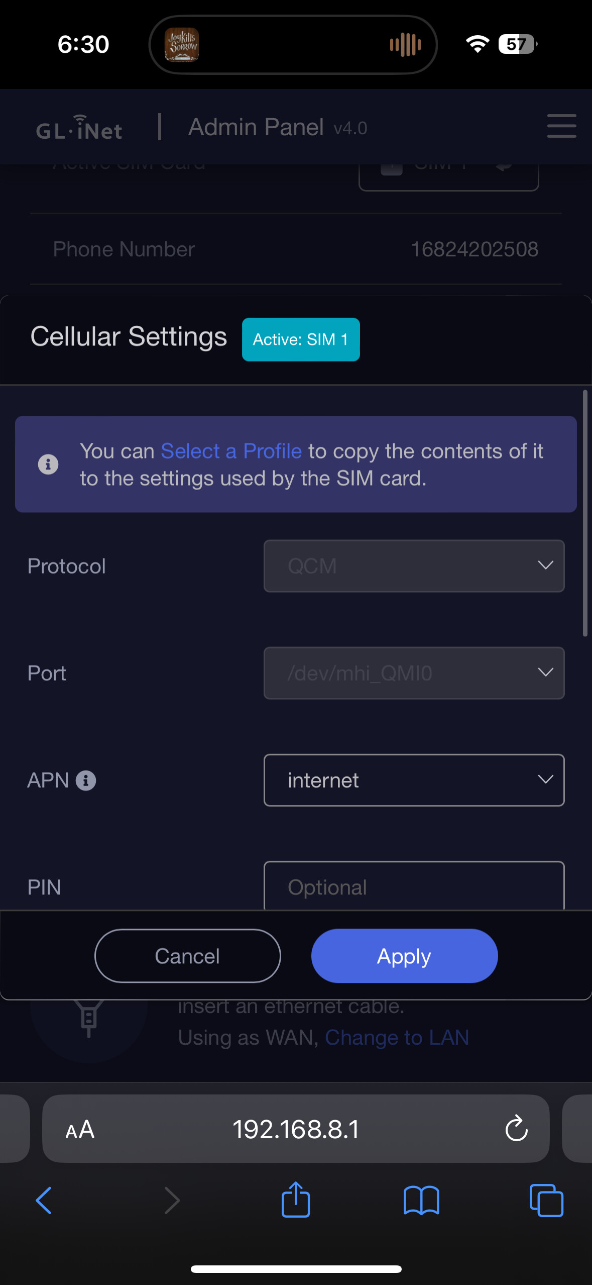

my spitz after X hours (they can be 2 or 20) disconnects from provider and never connects again unless I reboot.

What I have seen is than for some reasons the router changes the APN to a different one and disconnect. If I try to set back the right apn it does not let me do it unless I reboot.

Does your APN switch to "internet"? I have a similar issue but my provider lets you limp by at less throughput with the wrong APN, you can watch it dip to a throttled 5mbps with the wrong APN.
Can you change redial_sim to sim for a try?

Yes, it switches to internet and lose connection. Even If I select my provider profile it says "saved" but it does not. I have to reboot the router in order to use the selected apn but than after x hours it goes back to "internet".

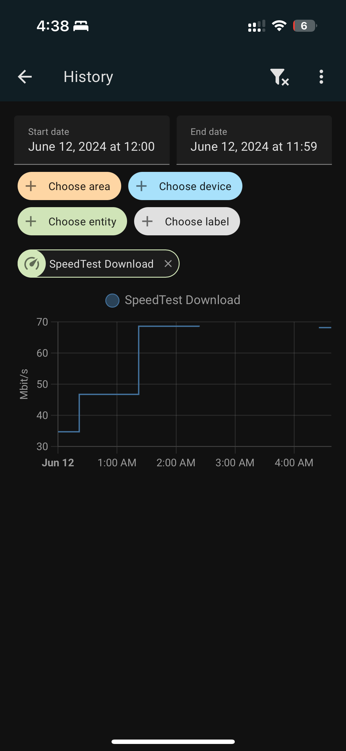

@bruce can we make the log screen persist the last reboot? I didn’t see anything before I rebooted. I have a pi on the same network if it helps, this is the device going down between 2:30 and 4:30 (it runs a test every hour).

Another day, another power cycle induced “internet” APN selection.
