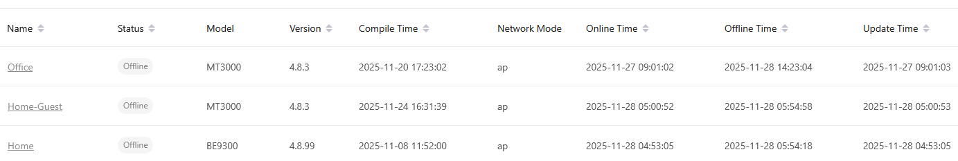

Strange that my router time is not updated even reboot. I was using 4.8.99 before and only do the update this morning. See the last online screen as below
Issues seems to be after firmware upgrade back to official version 4.8.3. I check the other router time is correct but still cannot register to GoodCloud. No Cloud log for that router.
I just update another MT3000 with the latest snapshot code. It is then break the GoodCloud connectivity and now it is also shown as offline. No cloud log found on the box.
