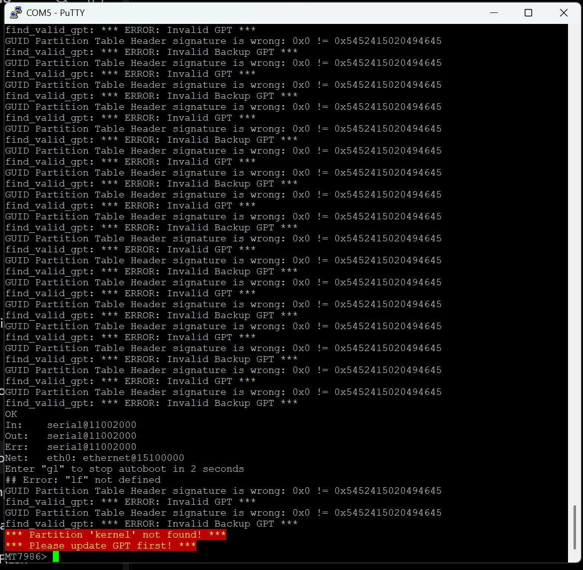

So I’ve acquired a router that previous user was unable to recover from whatever they were attempting.
I have received this message when in the puty terminal so I am optimistic if i can get GPT EMMC file for the MT6000 i can begin the recovery process to re-instate stock firmware.
