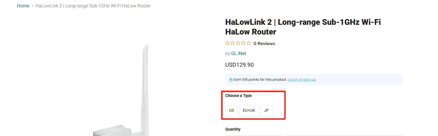

Can the HaLow frequency be changed from the software interface? (like from US 9xx MHz to Europe 8xx MHz, or to China 7xx MHz?)

  2. The HaLow frequency cannot be modified; it is provided according to the specific hardware version.
