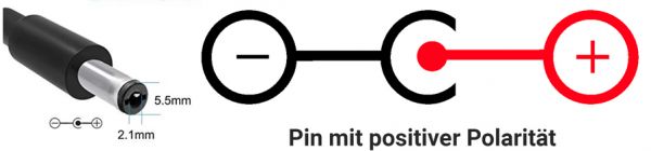

What must the pin assignment be?
Positive on the outside, negative on the inside
or the oposit side?
