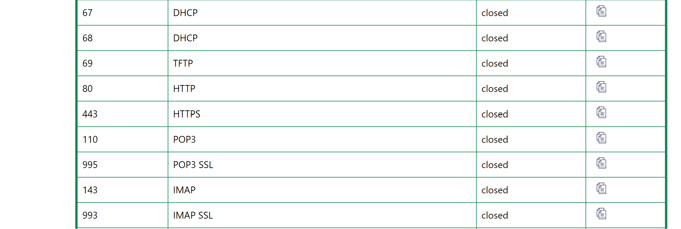

scan the WAN IP? to see which ports it’s listening on?
so it seems closed, but not sure how am I supposed to open it on the WAN
And the GL.inet does not?
no, it’s T-Mobile.

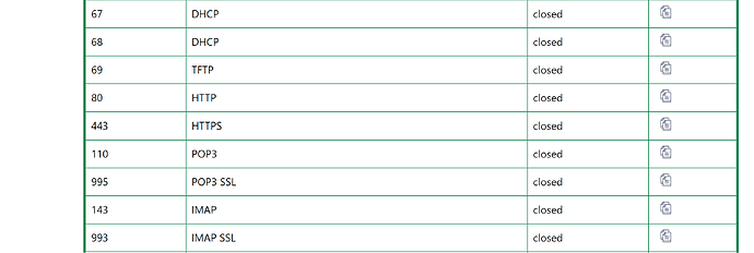

I just checked on the Asus side and the port is open on the WAN…
how the heck do I open it then? LOL
T-Mobile means Cellular?
In that case I am sure it won’t work. Cellular networks use Carrier-grade NATting - so there is no real IP for your router and therefor you can’t open the port.
