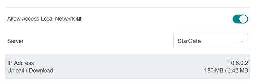

well it’s still not working. I can connect to the wireguard server and ping devices on the lan but I guess I’m missing some additional configuration because both internet and local device http interfaces are not working. I can’t access the MT2500 admin page even though I can ping the IP successfully.
GL-MT2500 VPN dashboard:
I’m using a Creta (GL-AR750) as the wireguard client:
I’ve connected my laptop to the ethernet on the creta to test, while the creta is using the repeater functionality to get internet from my cell phone hotspot. So the devices are on separate internet providers in order to test the tunnel.
In the scenario from the original diagram in the thread, I am trying to set up Profile1. Haven’t even gotten to trying Profile2 yet.

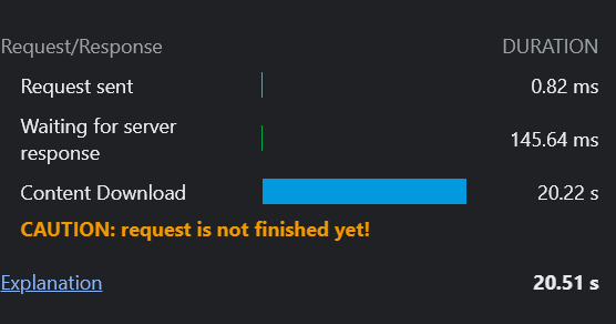

I don’t quite know what the problem is, but it happens with profile2 as well. Looking at chrome devtools gives a little more insight as to what is happening, but I don’t have any explanation for why it’s happening:
This is for the main javascript file request
