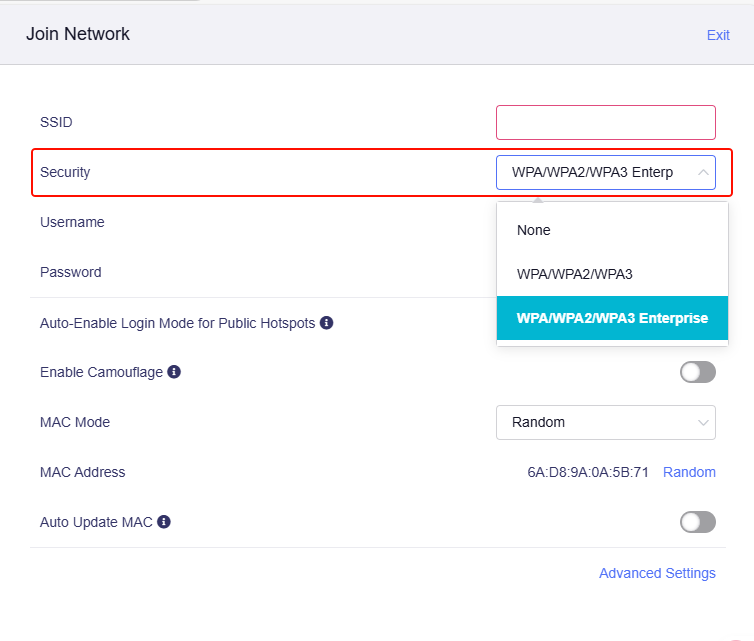

Hi all, I have purchased GL-AXT1800 ( slate AX) and want to connect to an WPA enterprise WiFi however I am not seeing the Security combo-box in the settings admin panel where I can select WPA3 Enterprise according to the online article “How to connect to EAP Network” ( Connect to EAP network - GL.iNet Router Docs 4 ) !
Where is the problem?
My router type is listed in the Supported models.

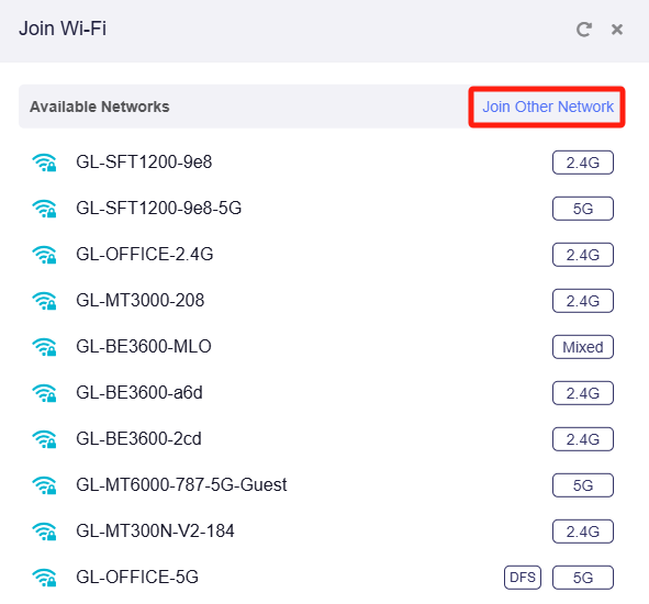

Please click the Join Other Network in repeater AP list, that you can find the Security combo-box WPA/WPA2/WPA3 Enterprise
