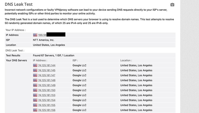

I’m using PassWall app, no DNS leaks

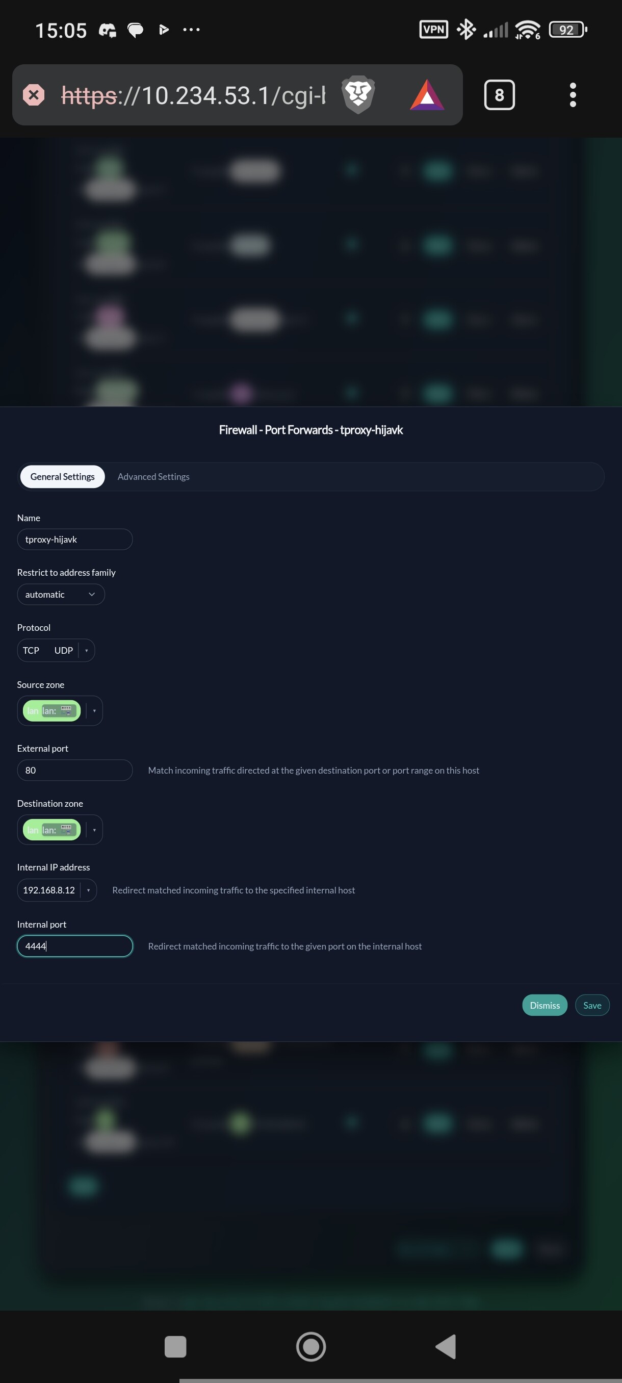

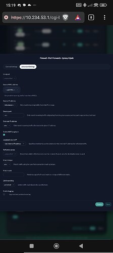

If you already setup a socks5 but it isn't transparant, there are some luci apps for it.
But if the socks proxy is not directly on your router, you can accomplish this with a hijacking rule.
Example:
If your proxy is on 192.168.8.12 and its port is 4444 and your device is also on the same network.
Click on advanced settings to go to luci, in luci navigate to network -> firewall.
Click on portforwarding, and create a new portforward rule as:
You could also set src to any zone, but requires editing the raw config and replacing it to: option src '*'
Now all http/80 traffic gets forwarded to proxy server on 4444 on the server client, if it is a remote proxy server just use wan as destination zone.
(Theme is different than normal luci :wink: )
Edit: fixed image ^^

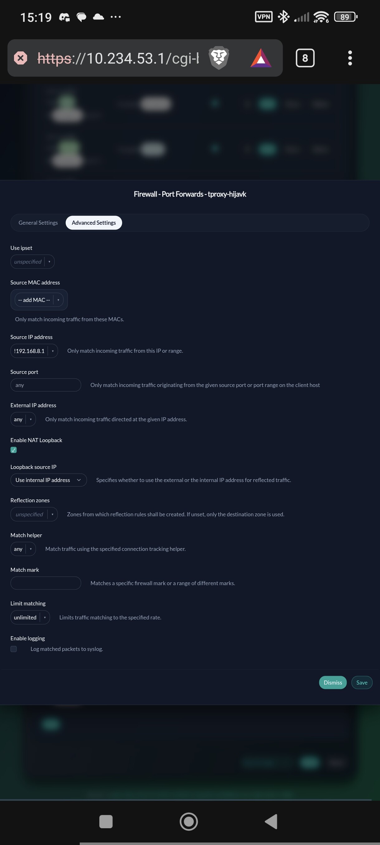

Edit 2:
I realized you also want to whitelist access to the router, this can be done on the same firewall rule but then on the advanced tab please see src ip.

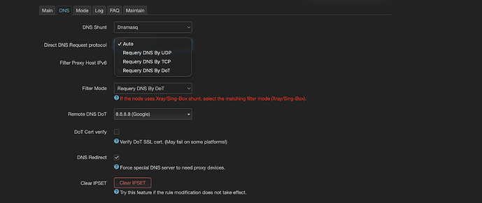

It is in DNS setting, and you can try by yourself, for me it works

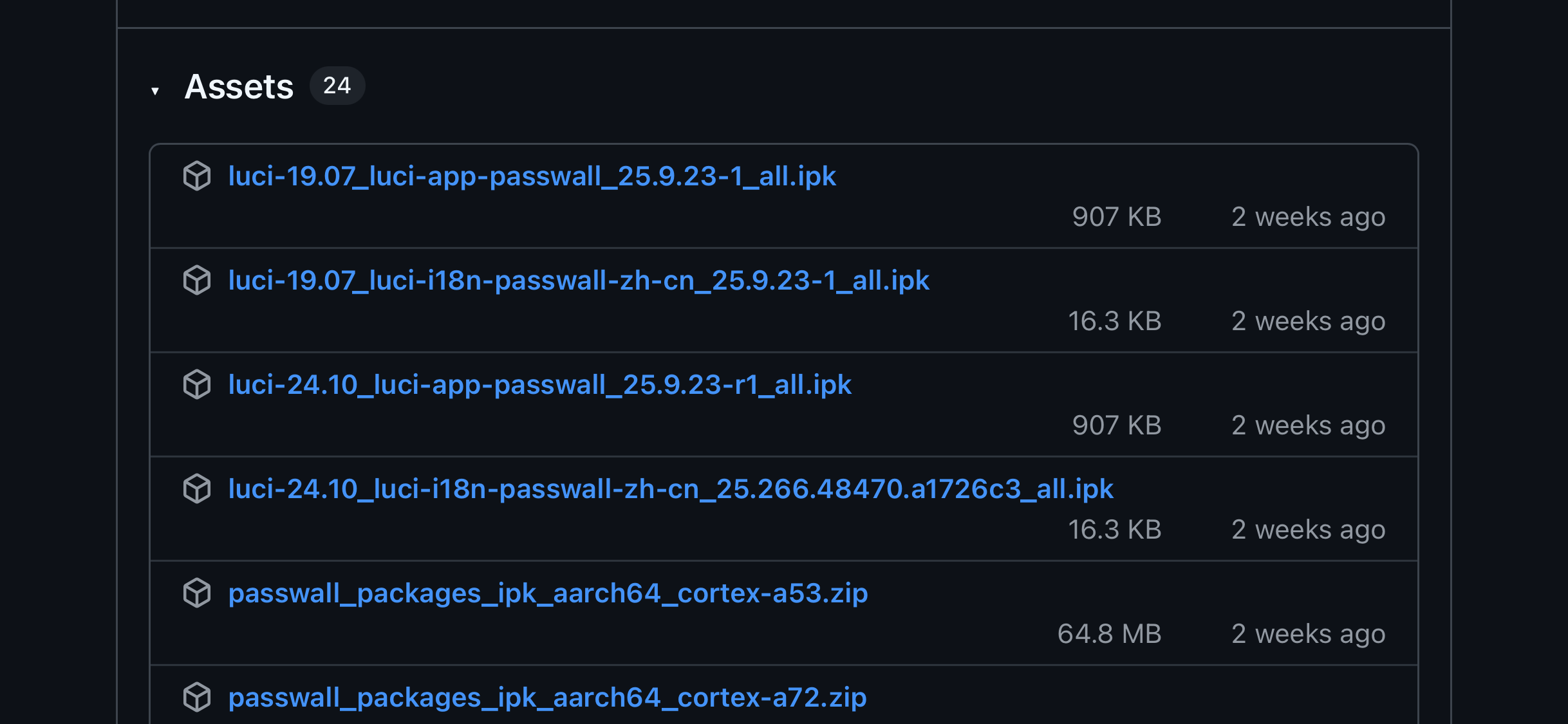

Yes, I understand but you just gave me the github link. Can you explain how you installed it on your router cause i tried to install it from the link but it is not working. Passwall is not listed in the plugin section sp how did you install it on your router?.
You must install the core proxy packages first (the "engines"), and then install the LuCI interface package (the "dashboard").
The quick steps look like this, sticking to the LuCI web interface for installation:
1. Install the Engine (Core Proxy Packages):
You need all the proxy clients (sing-box, x-ray, etc.) first. These are bundled by CPU type.
For my router (the Beryl AX MT3000), I downloaded the entire package set for cortex-a53 (that was the passwall_packages_ipk_aarch64_cortex-a53.zip).
Unzip that file, then go to System > Software in LuCI. Use the "Upload package..." option to install every single .ipk file inside the ZIP, one by one. If you miss one, the next step fails.
2. Install the Dashboard (LuCI App):
After all those core packages are installed, then you can install the LuCI interface package.
• I use OpenWrt 24, so I used the corresponding file: luci-24.10_luci-app-passwall_25.9.23-r1_all.ipk. Install this one through the same Upload package... method.
3. Finish Up:
• Give the router a quick reboot.
• You'll find it in LuCI under Services > PassWall.
Basically, the rule is: Install Clients (by architecture) > Install Interface > Reboot. Hope that gets you running!
Since you're on OpenWrt 23, the compatibility can be hit-or-miss with the very latest LuCI app. If you try the newest one and the interface gives you trouble (blank pages, errors), you'll need to browse the older assets on the PassWall GitHub page to find a version specifically built for the OpenWrt 23 framework.

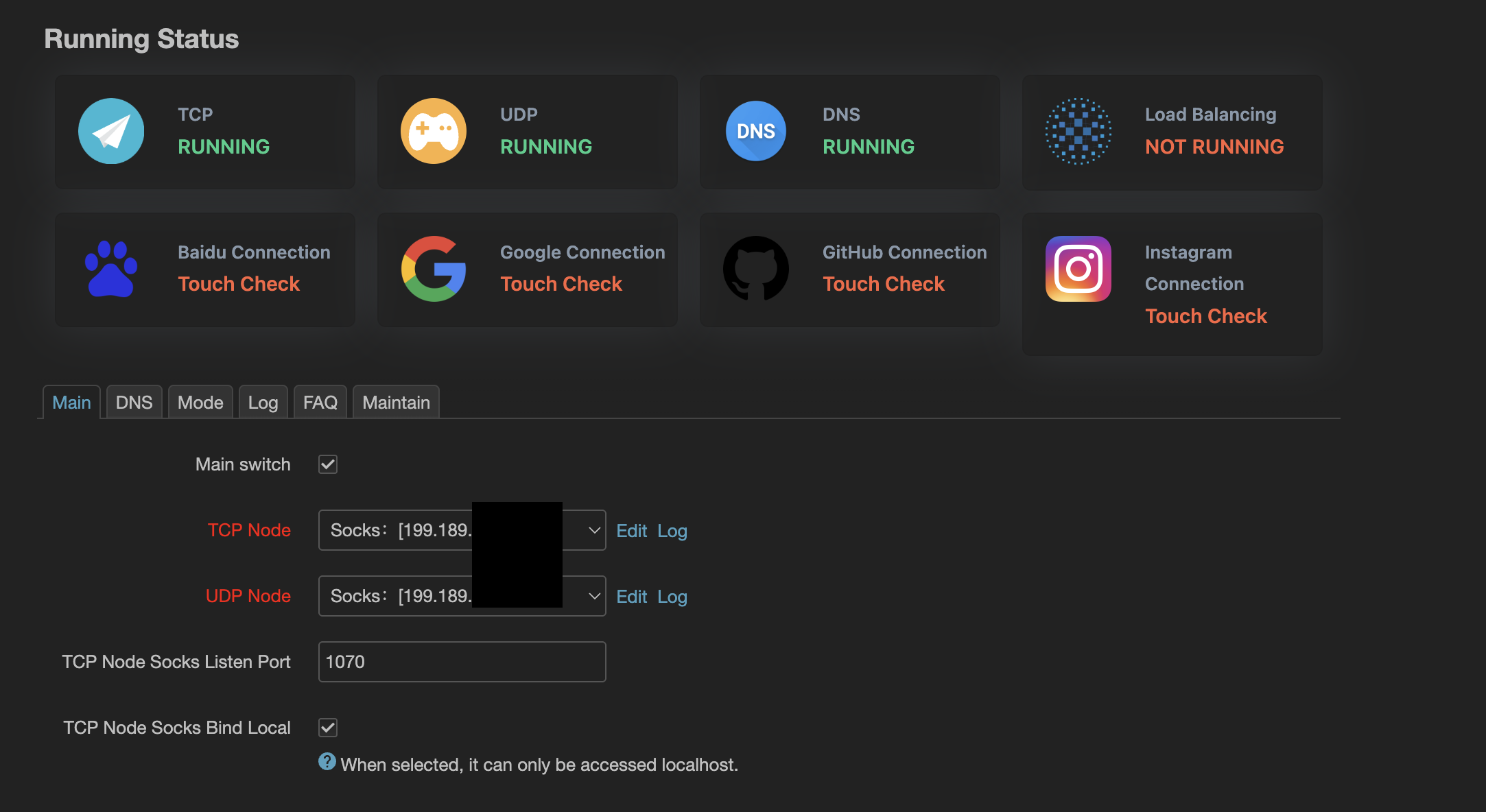

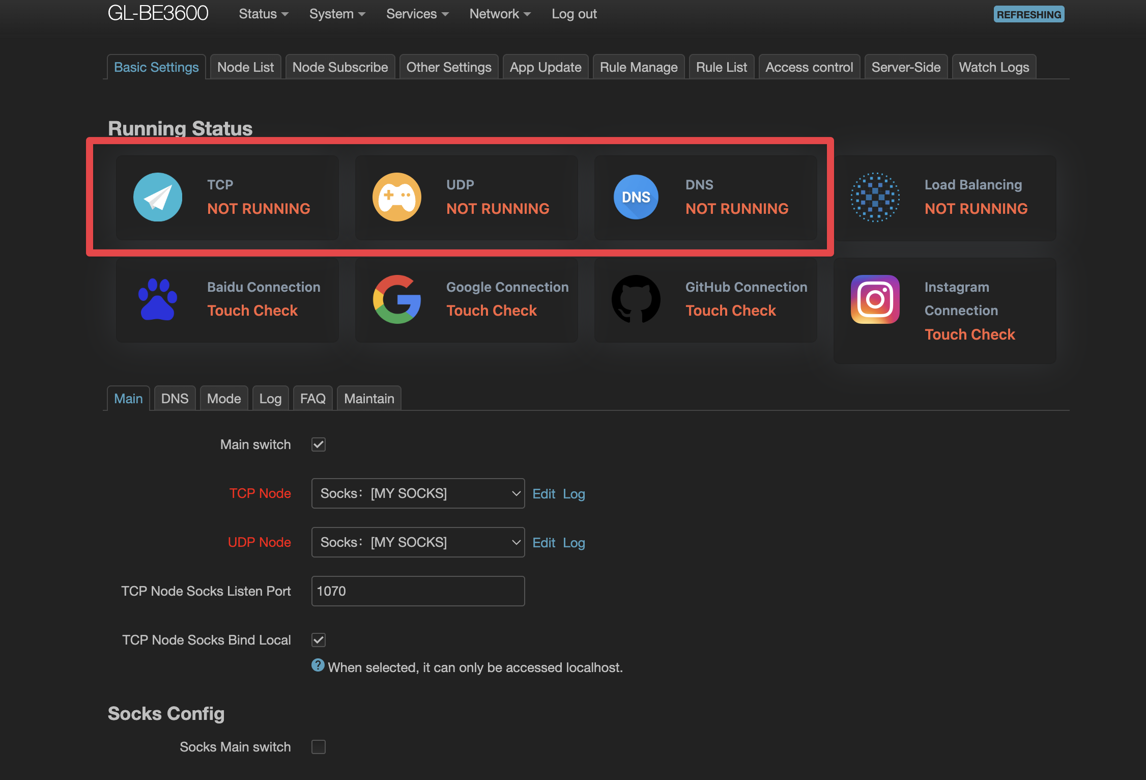

i have done everything here exactly to the later buy then its still not running. you can see from my screenshot below that TCP, UDP and DNS are all not running. what do i do please? am i missing something?
It’s weird
I don’t have slate 7, so I can’t guide you to troubleshoot this
Maybe this link is useful
You need to start it via command line
service passwall start
Bro this worked like magic. its fully working on my router without issues. thank you so much.

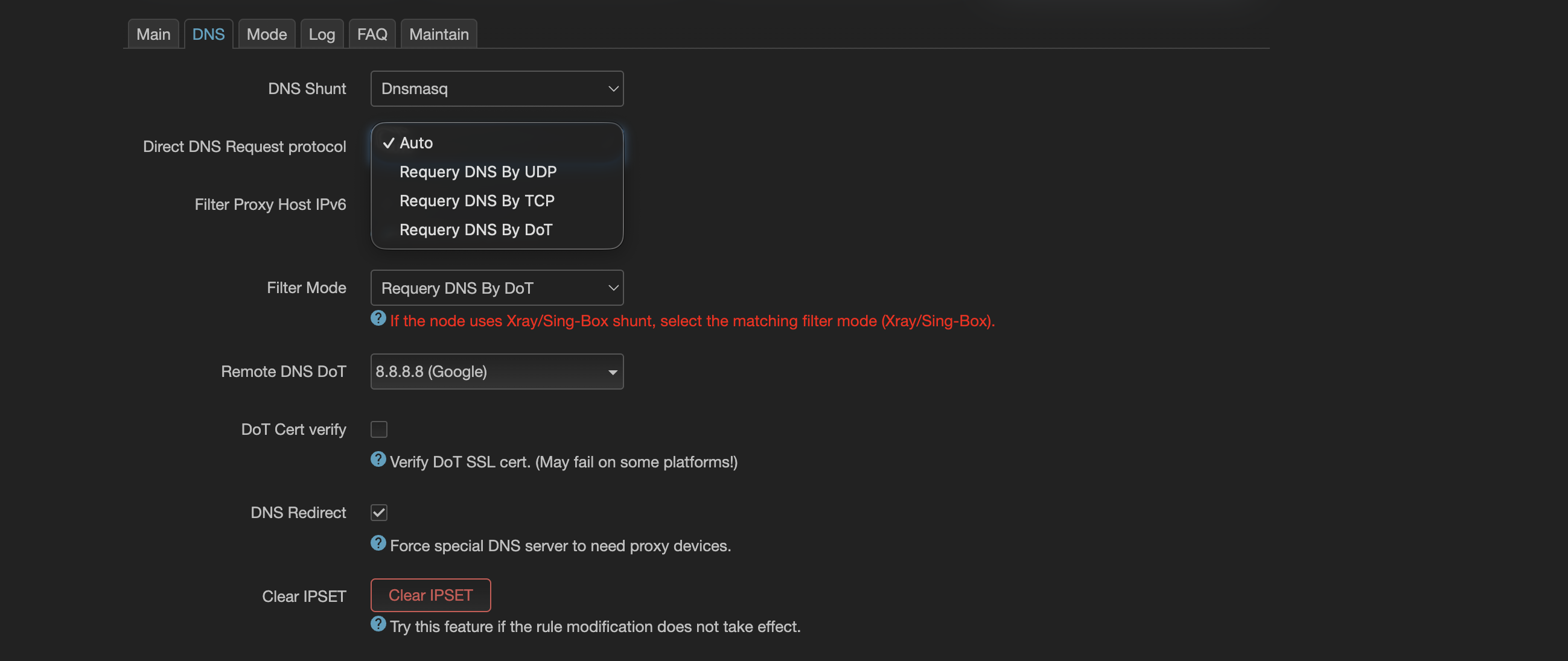

Could you possibly add screenshots of your Main, DNS, Mode sections Bonbon777. Im trying to setup the same as you with Socks5 but something isnt right and I think it may be leaking. Also sock5 selection isnt available it just says “Socks” Great work guys!
