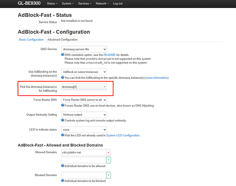

We tested this on Flint 3 running firmware v4.8.1, and the following steps worked on our side:
  1. SSH into the router and install adblock-fast:
opkg update && opkg install luci-app-adblock-fast
  1. In LuCI under Services > AdBlock Fast, configure it as needed. In our test, we selected the dnsmasq instance and enabled one list.
  1. SSH into the router again and enable adblock-fast:
uci set adblock-fast.config.enabled='1'; uci commit adblock-fast;
/etc/init.d/adblock-fast restart
Test results are shown above.
Reference: Welcome to docs.openwrt.melmac.ca! | stangri’s OpenWrt Packages Documentation.

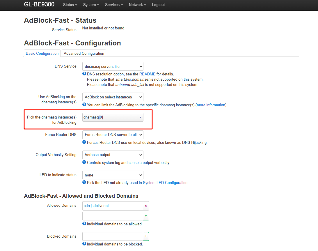

Thanks. Thats what I did previously…. And it all seems to work fine from the temrinal.
However from the services → adblock fast web gui I see:
AdBlock-Fast - Status
Service Status
Not installed or not found
However from the ssh console it looks like its working:

So i assume its jut an issue with the webgui?
Edit: blocking is working, seems like just a gui issue!

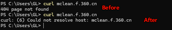

curl mclean.f.360.cn
curl: (6) Could not resolve host: mclean.f.360.cn
