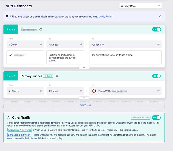

Is this setup ok? All I want is my work PC to bypass VPN while all other devices on VPN
You don’t need the first policy, just exclude your pc in the second policy.
Yes, that is exactly how I do mine.
I got thesame setup but my work computer will not browse the internet or connect to work VPN
