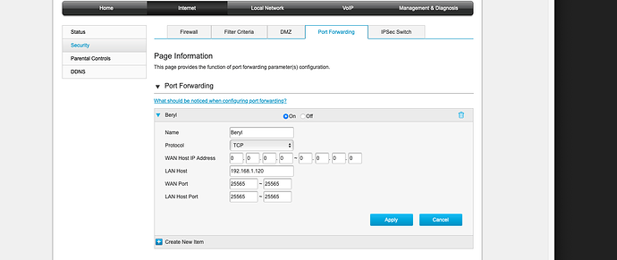

Can you show how it was portforwarded on isp ui?
@xize11 sure - please find the screenshoot attached.
Thanks, that screenshot seem to look fine but to be sure:
Is the 0.0.0.0 required or can it be applied empty?
^ please try it as empty.
