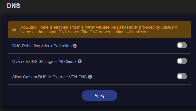

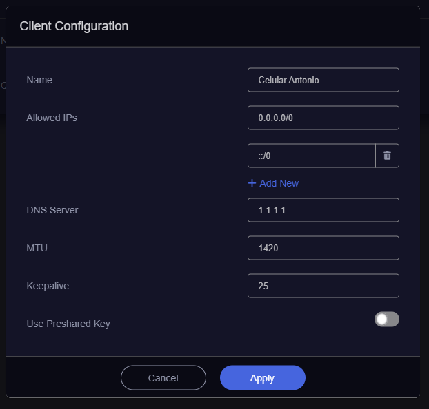

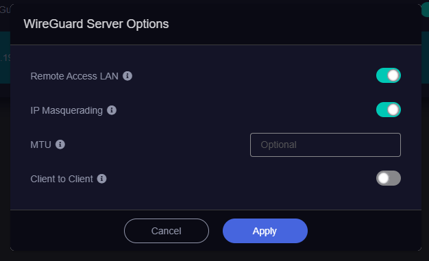

I am having problems connecting to my public URL (HTTPS) for my Home Assistant instance when connected to Wireguard over 5g. I believe I'm missing a setting because it works when I type the local IP address.
I'm also using NGINX server for the HTTPS redirect.
Got it. I'll investigate it further. I was wondering if since I set the VPN server to access the local network devices and NGINX is also on the same local network, they all have access to both inbound and outbound public internet packets, why this doesn't work. Thank you.

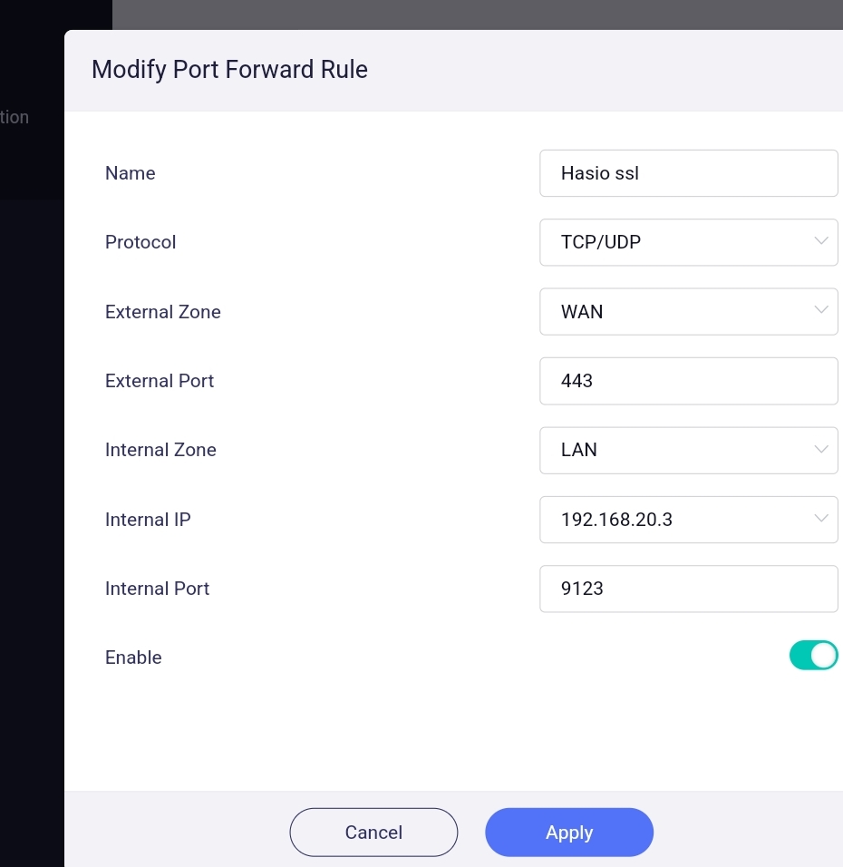

I have similar problem but I sorted out with duck dns inside home assistant. Just open port forward in gl router.
If use https (ssl) then port 443 - 8123 (default homeassistant port)
