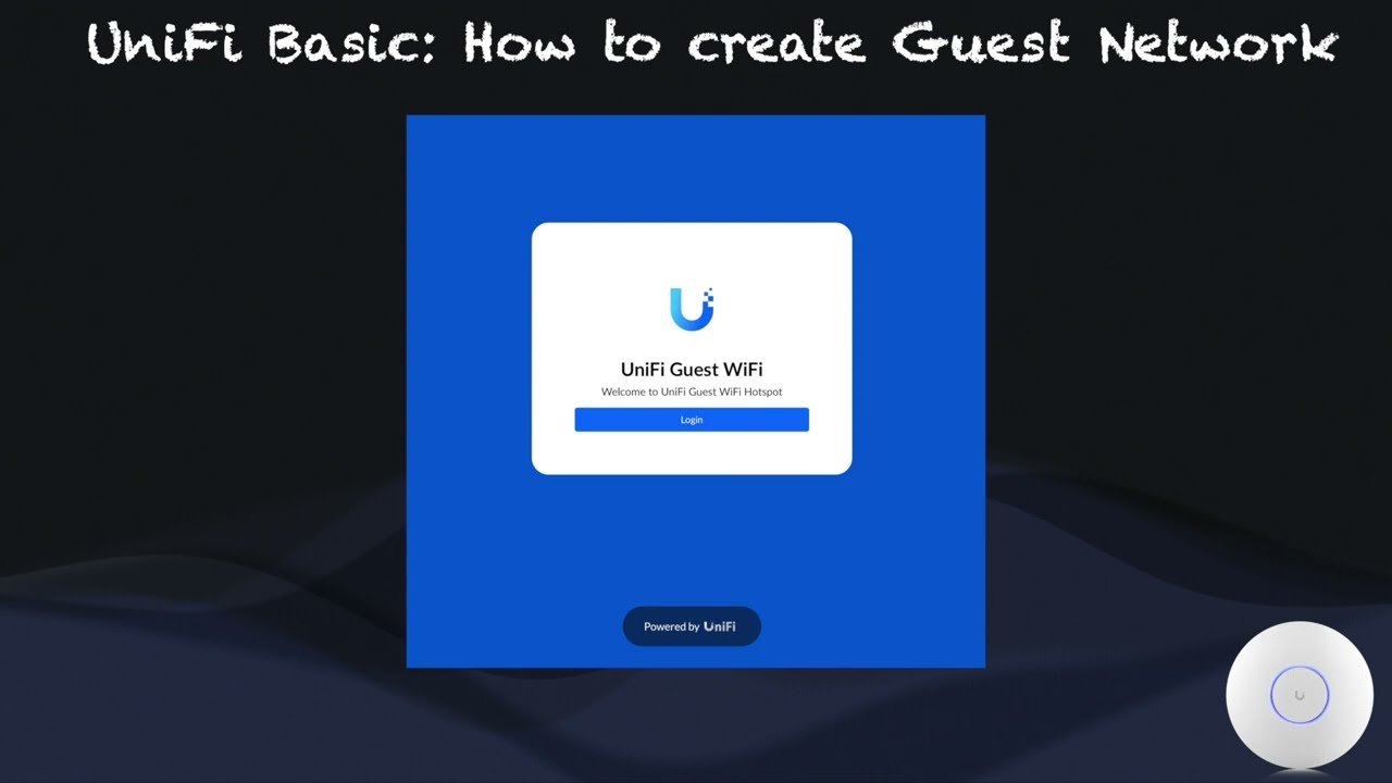

It uses the parent's router's same IP subnet but has this beautiful and unique feature called the hotspot portal that helps you create an isolated and guests dedicated wifi (you do not even need to have a guest network on your main router):
Also see here:
