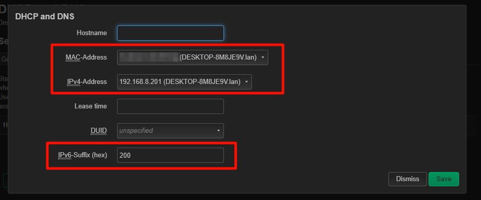

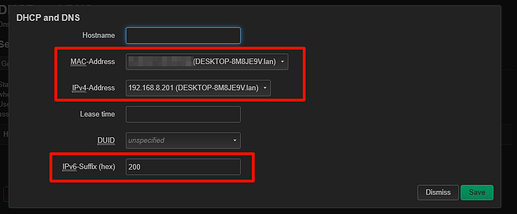

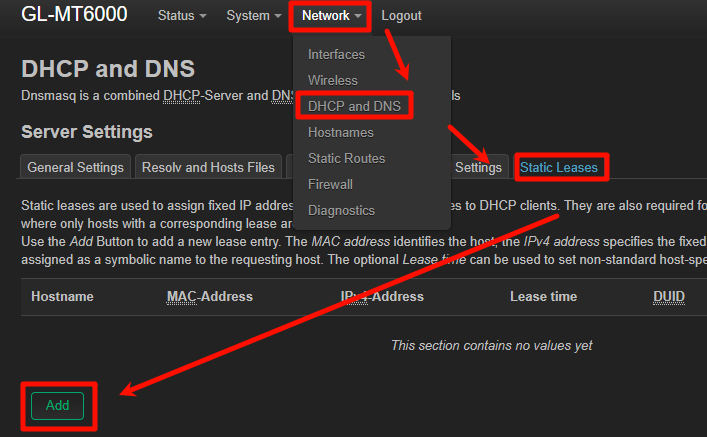

Currently, the GL UI does not support IPv6 address reservations.
You can configure this using the IPv6-Suffix under Luci → Network → DHCP and DNS → Static Leases.
Since the DHCP feature of AdGuard Home is not enabled, this will have no impact.
