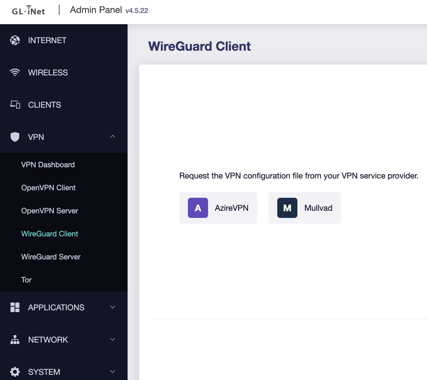

Hi there,
I have a GL-A1300 on which I’m trying to set up my NordVPN WireGuard client. The documentation ( WireGuard Client - GL.iNet Router Docs 4 ) shows a lot of providers but mine only shows AzireVPN and Mullvad.
I even went through the process of re-imaging the router through the uboot process thinking maybe it would restore the complete list but as you can see, it didn’t.
Does anyone know of a way to restore that? The docs say NordVPN uses an access token but when going through the process of adding a WireGuard client manually, that’s not an option.
Thanks!
NordVPN WireGuard support was introduced starting from firmware version 4.7.
Since your device is currently on version 4.5.22, the option will not appear in the menu.
You can try the feature by upgrading to the 4.7.2 beta version:
Download: GL.iNet download center
Upgrade guide: Upgrade - GL.iNet Router Docs 4
Perfect! Thank you SO much!
