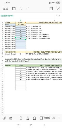

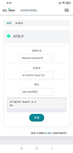

1+1 AT+QCFG=“band”,0,2
3+3 AT+QCFG=“band”,0,8
AT+QNWINFO
+QNWINFO: “FDD LTE”,“46011”,“LTE BAND 1”,100
OK

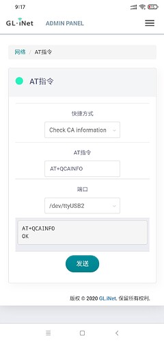

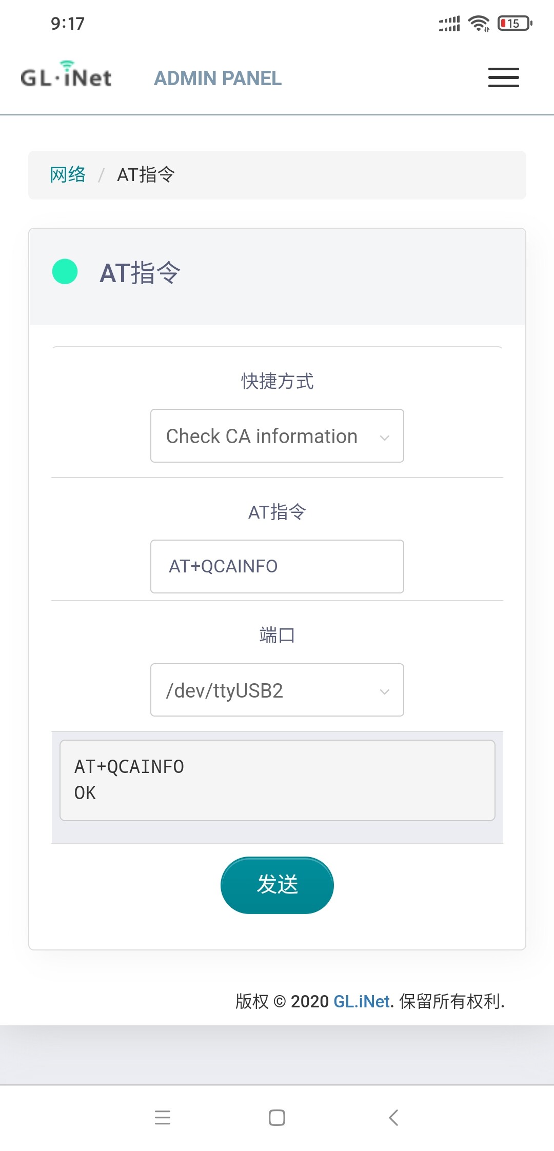

AT+QCAINFO
OK
CA aggregation information not found
AT+QNWINFO
OK
AT+QCAINFO
OK

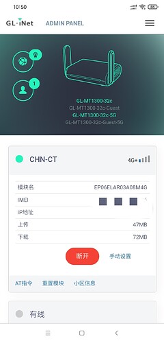

What country are you? It seems that the module is not suitable for CA aggregation here. EP06 does not support 1 + 3 special code. 1 + 1 + 3 + 3 combination has no effect. Is the device automatic aggregation?
